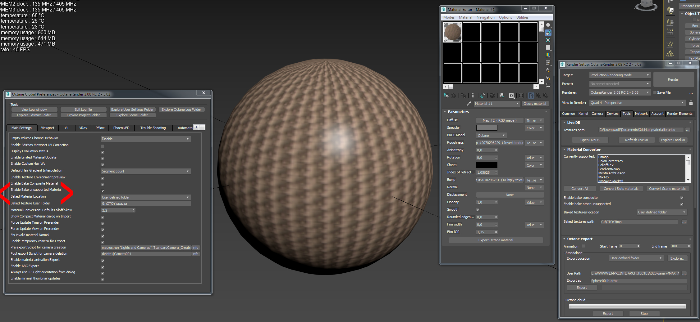

Hi, when converting Vray models, sometimes octane baked maps are not found by octane and make octane viewport restart every 2 s.
You can test to convert the file.
Baked map restart render

Hi HHbomb,HHbomb wrote:Hi, when converting Vray models, sometimes octane baked maps are not found by octane and make octane viewport restart every 2 s.
Everything seems to work well, would you not check anything in Octane Global Preferences?
Regards
Paride
Baked material Location was "Current max file folder", Baked Texture User folder path was empty, and my scene was a new non saved scene. I think octane doesn't know were to re-upload the baked texture.
I changed settings and now it works.
Thanks !
Thanks !
