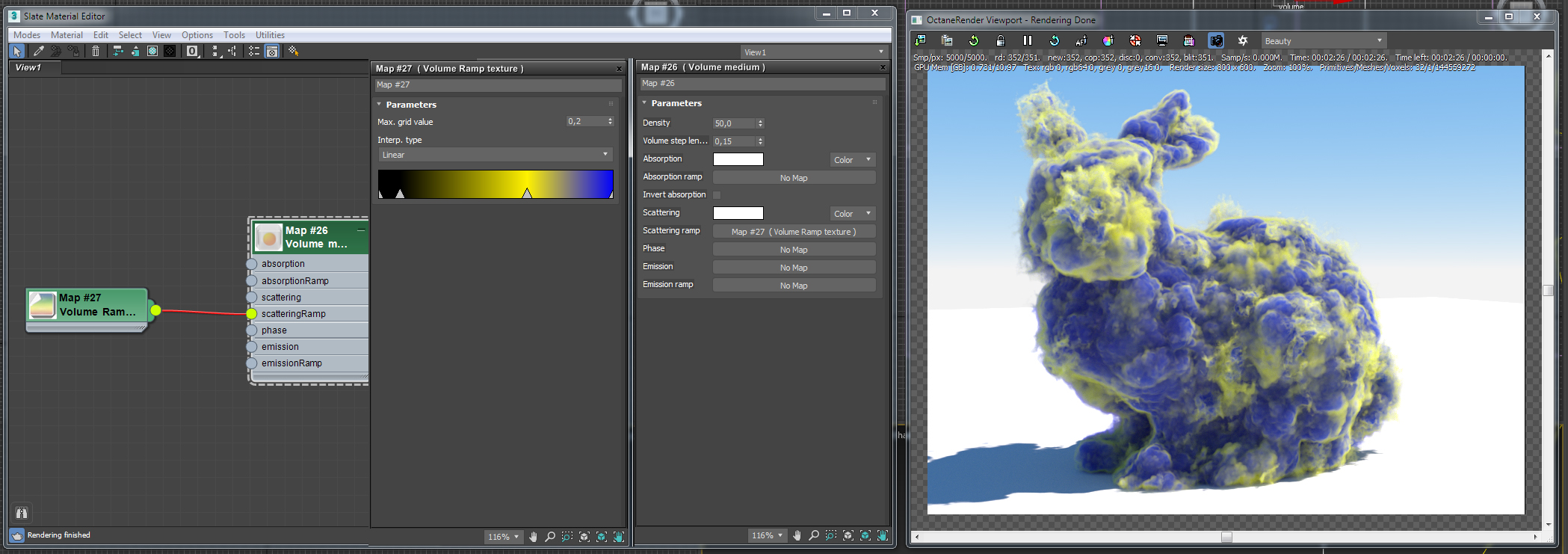

Hi Paride
can you set a quick sample for the Medium Node use and Radius in the Daylight System? I see there are also new nodes like Volume Medium and Volume ramp..
Sorry but did not work much with the Dev release of the 3.08 standalone so far...

I justix,
here some post about medium node:
viewtopic.php?f=21&t=56599
viewtopic.php?f=9&t=56728&p=291355&hili ... um#p291355
Regards
Paride

justix wrote:Hi Paride
also if you open octane viewport and go to the top view you can actually see the radius as a dark sphere over your scene
