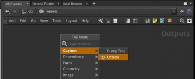

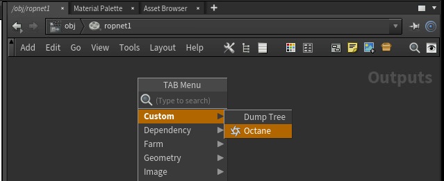

The problem is that the tab "Render->Octane" option is using the shelf tool to create the ROP node, and this tool is a script that always adds the ROP in the /out network.
But if you the Octane ROP from the tab "Custom->Octane" option, the ROP node will be created inside your current network, as expected.
Hope this helps,
-Juanjo
