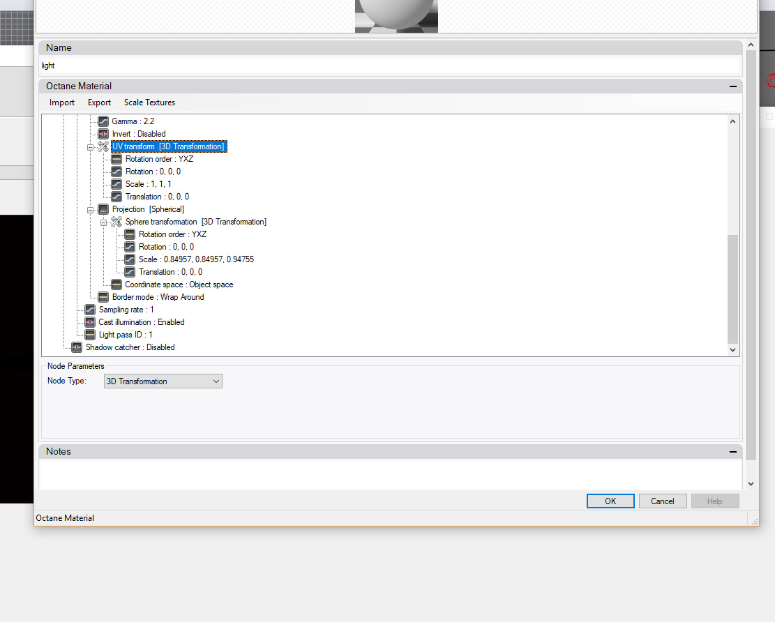

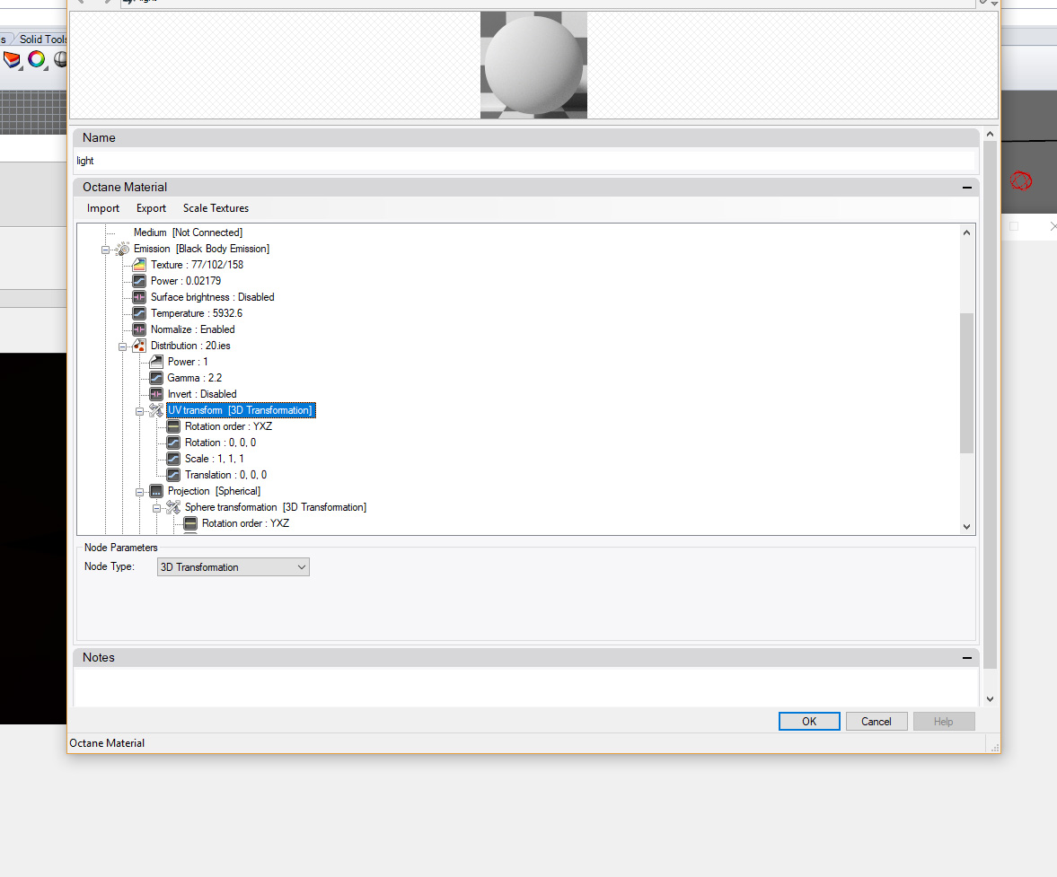

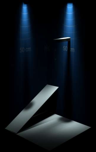

I need some help getting lights to face in the right direction.
I am using a flat plane as the emitter in the model
I have used a black b ody emitter
I have set the texture to RGB colour and set blue for an underwater look
Distribution is set to an RGB image and I have loaded an ies file
UV transform is set as standard
Projection is SPHERICAL (should it be UV or linear but these don’t seem to make a difference)
When I use the rotation input I can only rotate in one direction side to side but cant rotate forwards and backwards no matter how I set the XTZ, ZXy etc.
Any ideas would be great.

To rotate the IES light, use the X and Z sliders of the Rotation pin in the Sphere Transformation node.

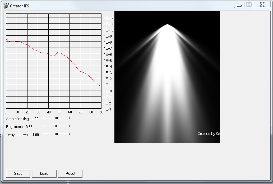

An idea - could the little free tool "Creator IES" or something like this not be direct added to the Rhino UI? The created IES files could be internal saved to the Rhino file. And finally the IES could be aligned to the surface normal, so that the user can direct rotate the surface if needed.
Win7 64 | Dual Xeon E5-2687W | GTX 1080ti 11GB + GTX 780 6GB | Rhino3D

I might be wrong but I think that this ies app was created by Karba (f-Storm creator) :-)
Anyway I'd like to have a simple cone light control which could be converted into a ies file. I don't think it is difficult to do
