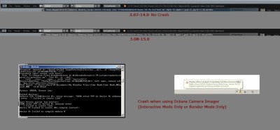

Hi. When opening a scene that I've been working on in 3.07-14.0 into 3.08-15.0 along with the response curve not loading
there is also a big difference in rendering time and vram usage between the two distributions using the same .blend file.
When using the preview mode with the the Octane imagers in 3.08-15.0 the NVIDIA driver will crash about 3/4 way through
the samples I've set for it. The NVIDIA driver will not crash when not using the Octane imager. After this I can not shut
down the Octane server with a right click on the Octane icon in the tray, I have to use the task manager to stop the Octane
server process.
server process.
