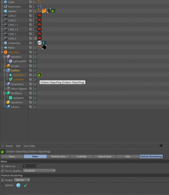

My particles are showing in the Live Viewer and when i render to Picture Viewer. The issues is when i try and render via the render queue - i just get a black image.
Everything looks like it's setup correctly, i'm just totally stumped as to why it's not showing up there.
Octane ObjectTag with Particle Rendering in place. HELP!!!???

So classic answer: Did you tried to cache it and check off "render perfect" in sphere?
Buchanero
Posts: 20
Joined: Sun Nov 27, 2016 5:41 pm
Thanks aoktar! That fixed it. It was just the cache that needed to be built before it would show.
Thanks as always for a super quick response!!
