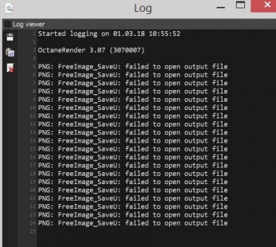

Hi Paul,
How can I detect cause and get rid of this error: "PNG: FreeImage_SaveU: failed to open output file"?

Hi Jeroen, I have not seen that error before. Are you sure you have write access to the file and folder you are saving to? If so, then can you pls open a ticket via the Support->Submit a Request button at the top of this page so that OTOY can investigate the issue.

Hi Paul,
I am having this error while rendering, not while saving or doing something else.

Thanks Jeroen - can you pls open a ticket for it.

It mostly caused on uncommon characters used on the directory structure.
like
c:\look at this letters ÜİŞÇ\new project\project.fileextension
