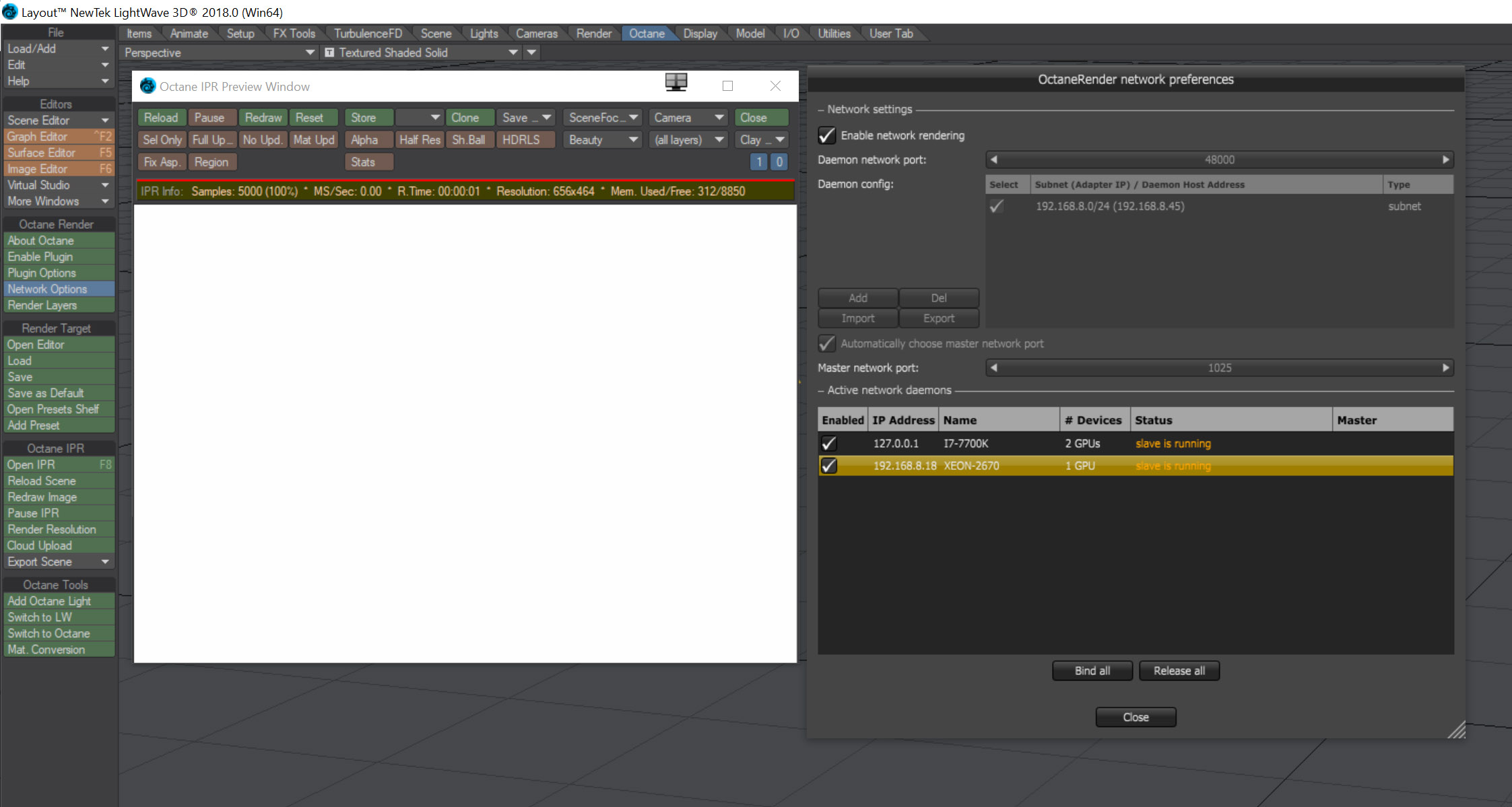

ruuterdetuuter
Posts: 86
Joined: Tue May 02, 2017 8:41 am
Here you go Juanjgon,
This is a screengrab from LW 2018 but the same goes for 2015.3
As you can see The IPR (as well as the F10 render) only shows 2 GPU's where it should show 3 in my opinion.
Thanks in advance.
