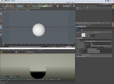

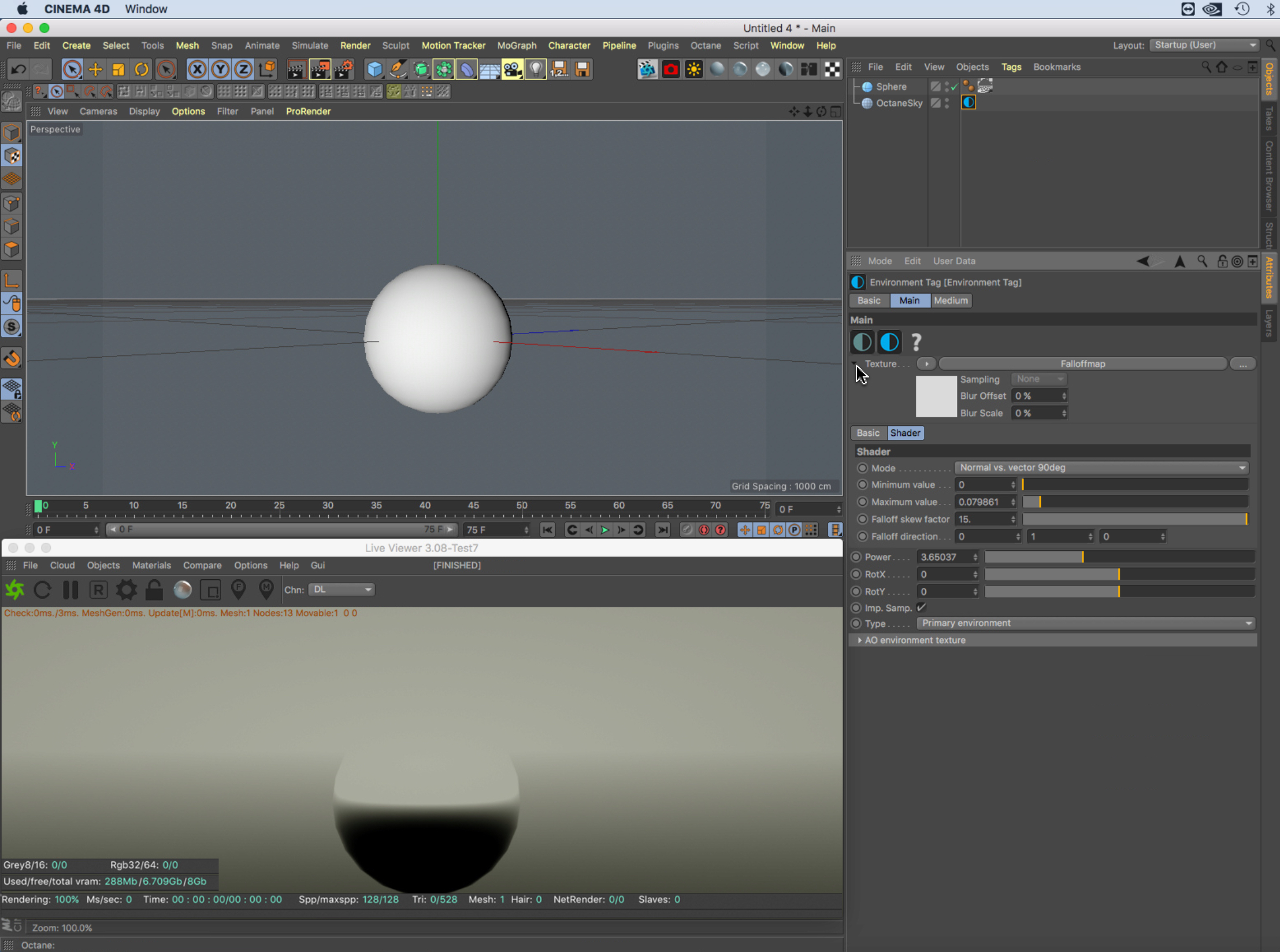

Thank u very much for the help! One more question if its not a problem hehe. Is there possible to make a dome light with a gradient instead of an hdr?
Studio21
Posts: 212
Joined: Wed Nov 16, 2016 11:14 am
yes u can. use a textured environment and plug a gradient in the texture slot
Posts: 10626
yes sure, you can use any kind of node combination in the Environment node, for example a Falloff node at 90°:
