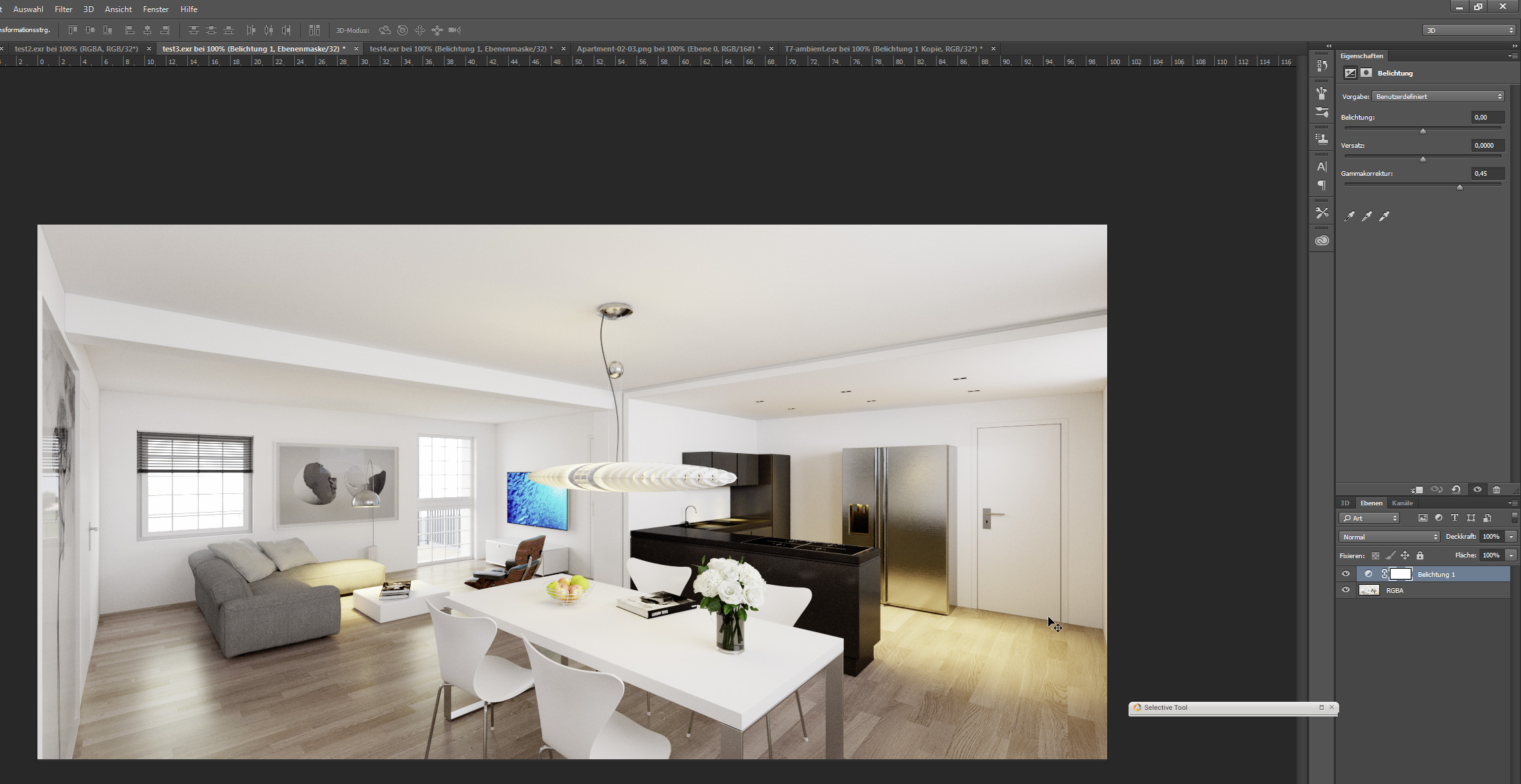

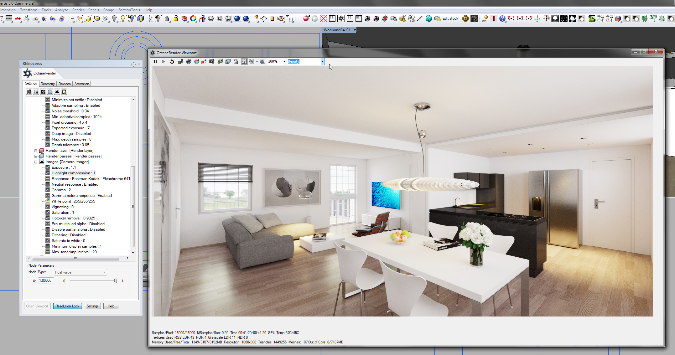

Ok, I was able to save a tonemapped exr file, opened it in PS and applied a gamma of 0,45 ( 1 divided by 2,2 ) the image resembles the look of the octane render viewport, in this special case I used : Exposure :1.1 , Highlight compression :1 , camera response curve : Ektachrome64TCD , Gamma: 1.1
So when saving as single layered tonemapped exr I am able to mimic the octane viewport look in PS. However if I use the "save layered exr" button in the octane viewport, the resulting file does not seem to be tonemapped (I am using the octane for Rhino plugin by the way...) when importing the tonemapped exr in PS the image looks kind of washes out, which is then fixed by applying gamma 0,45 as mentioned above, the layered exr on the other hand looks like it is saved as a regular exr , which i cannot turn into something like the octane viewport...
attached 2 Images, one is a screendump of the octane render viewport, the second is the imported tonemapped exr image with an gamma of 0,45 applied :
as you can see, the files look the same (apart from the bloom glare effect I forgot to turn off...)
Is there a way to save the layered exr tonemapped ? Or is this nonsense since the composting in PS will not work properly?
