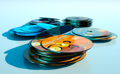

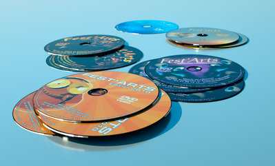

here are 2 pictures i've done for my job because a client of me asked a photograph of the DVD i realised for him (to print in a magasine).
Instead of shooting the disks , i realised 2 octane renderings...
It is not very complex but to my mind realistic enough...
Hi-res calculated in few minutes with Octane !
Octane for replacing studio shoots
It looks like you don't have smoothing enabled. Faceting shows up on the edges. I'd also bevel the edges a bit for shots that close. good work.
You're right: i forgot to enable smoothing for the bottom picture !
These DVDs are low-res polys and it can be detected.
In addition, the floor is too blue but the goal was not to be ultra realistic but just enough... with one more hour of rneder-matter adjusting, it would be possibble to be more "phot-like" but this scene was just the answer to an external demand. I prefer to spend more time on creative things...( but I spent a lot of time to adjust triangulation for the obj-export in lightwave 10.1 beta: it was non planar polygons which were disturbing uv-maps a lot !)

yep, I use Octane to do pretty much all the product shots for a company I work with. Works wonderfully well, just replace the wrap on a DVD case with a stack of DVD cases in the BG, and I can whip out lots of shots in a day w/o any trouble.

Good looking images.
To my eye the disks look too thick.
Also maybe not show the underneath of the disks. Reproducing the isotropic specular look of CD's and DVD?'s is no easy thing. Not sure if it's possible with Octane.
