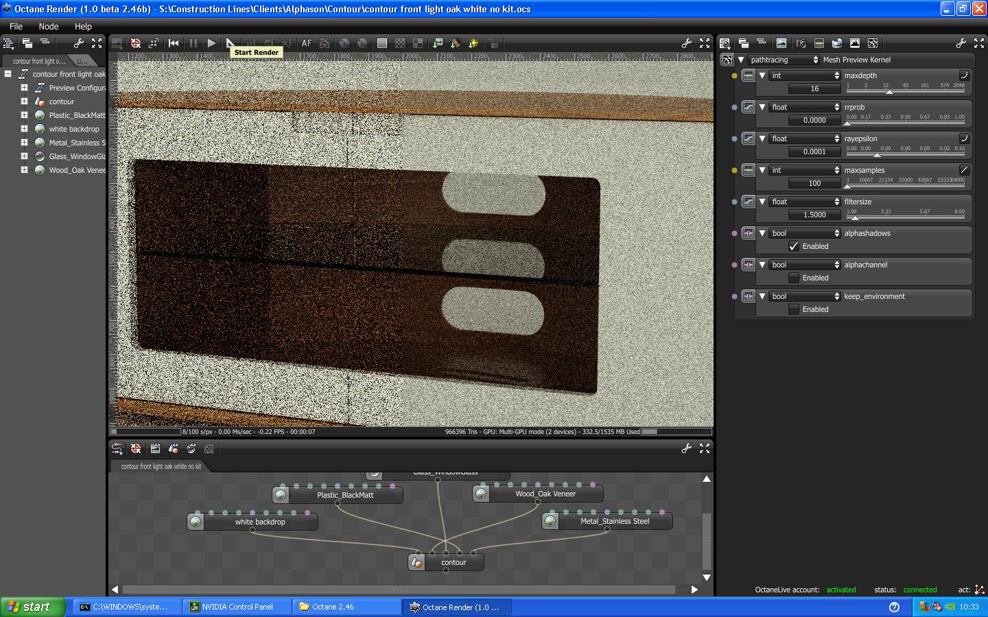

I have just recently installed a GTX590 for faster rendering with Octane and have come up against a problem straight away. I am using the correct version of Octane and the correct drivers so now need a bit of help of sorting it out.
When i render a scene i get the rendered image split in two and one side is clearing faster than the other - it is as though the image is being rendered by two different cards of different power. Also the amount of CUDA core available in my preferences is 512 - is this correct?

We are currently on a complete rewrite of the multi-GPU stuff, which will solve these problems.
By the way, could you please post an image that shows this problem, because I can't reproduce these effects at work? I also would like to know which build exactly you are using and which driver version.

i am using the version 1.0 beta 2.46b with the Nvidia driver 270.61 which is CUDA version 4.0 (I only recently updated the nvidia driver and i was getting the same problem with CUDA 3.2)
i have attached a screen grab of the problem.
1. is this an Octane problem or a problem with my settings?
2. i have tried multi gpu disabled and get the same problem. Does this mean anything?
3. The speed is about the same with or without multi gpu. Is this correct?
4. if this is an Octane problem and the new rewrite will sort it, is there a workaround to get a single card speed without the split image while we wait?

Ah yes. I have seen that before: For some reason the OpenGL texture (/pixel) sampling works differently for different GPUs when the zoom factor is <100%. If you zoom the viewport to 100% or higher the noise should be exactly the same. We haven't really investigated this problem yet, because it's only a display issue. If you save the image the noise should be equal, too.

OMG you're right.. That's saved my a*se!
