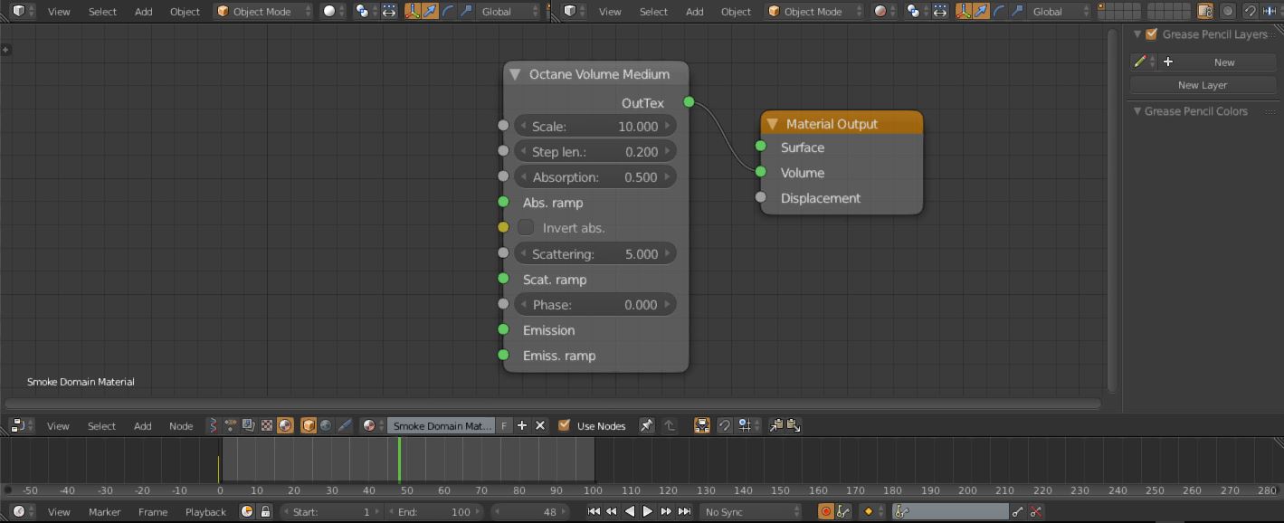

Be sure to have an Octane Volume Medium node attached to the Volume input of the Material Output, and play with the values.
The ones you see in the attachment should let you see something more similar to some smoke than to a cube! ;)
I hope this helps.

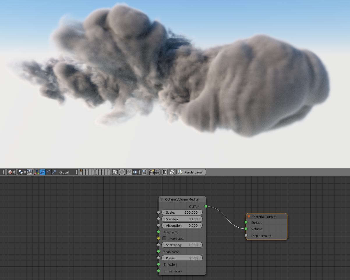

J.C
Posts: 1874
Joined: Thu May 13, 2010 6:35 pm
Location: Wrocław
Try decreasing "Step length" to something 0.150. Be careful, if you go to low it my freeze the rendering.

J.C
Posts: 1874
Location: Wrocław
