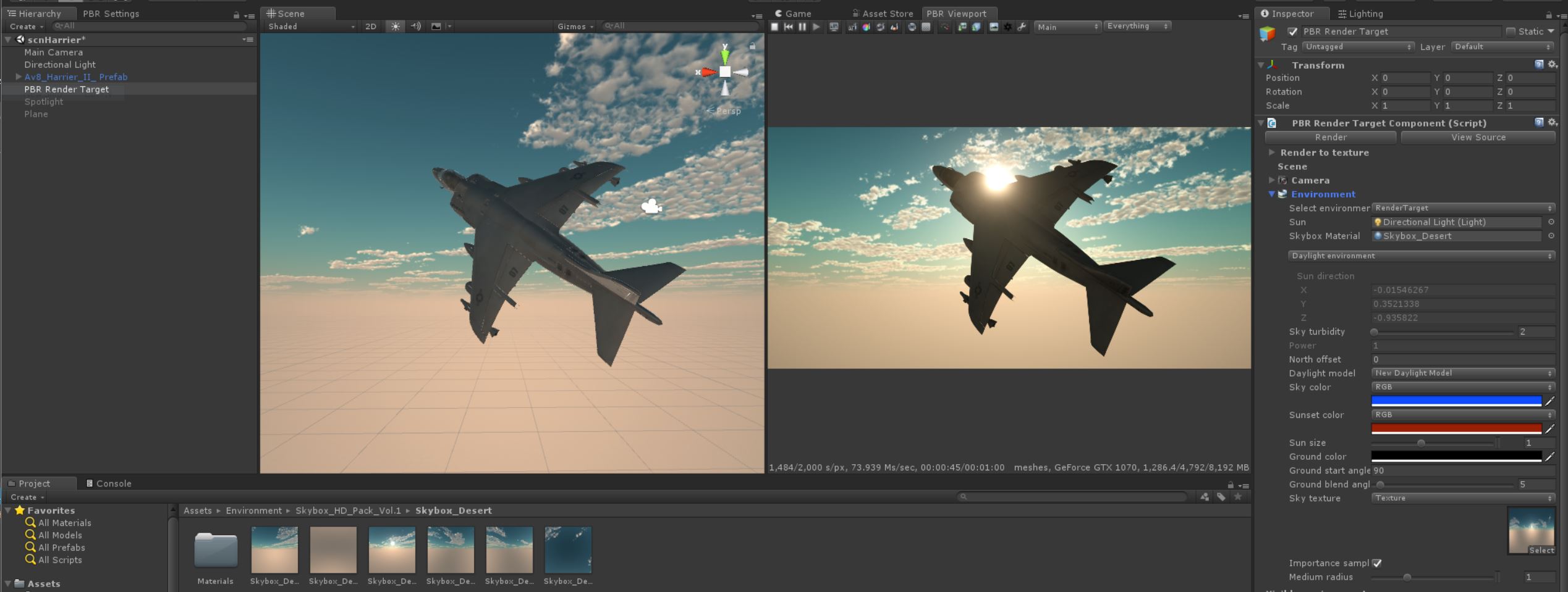

In the meantime, can you see if this solves your problem?:
- Go to the PBR Render target and, under Environment, set "Select environment settings"-dropdown to "Render Target";
- Assign a new or existing skybox material;
- Make sure the Texture dropdown is set to "Texture";
- Assign your skybox image there.

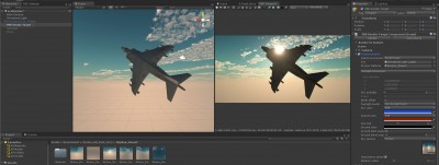

Converting the Skybox to a pano, certainly fixed the problem. I found one tool that could do it, but not without issues.
https://www.youtube.com/watch?v=LcQb3UDDgQ4
Front to back orientation is still wrong in this grab, so it would take rotating the up/down images 180 and then sliding the side images around 2 spots.
Anyway, I'm happy with this as a workaround for now.
