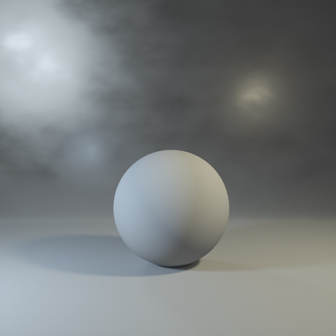

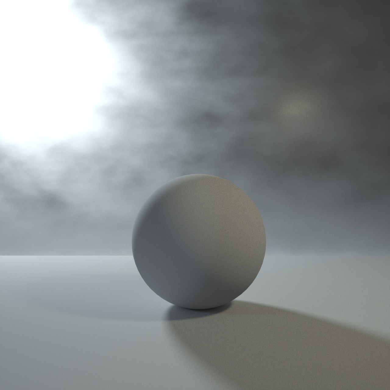

Is this the kind of effect you had in mind ?
It's just a quick simple setting with three lights,
one being behind a "frosted" specular material with just a turbulence noise
plugged into a gradient in the roughness channel...

Thanks guys, that is the kind of thing - I put some roughness in the spec channel and it's working nicely. I'm using it with an octane light behind so that one edge of the light is touching the diffusion and one edge is rotated away, it gives you a nice gradient fall off in reflections.

Consider also you can use the medium and transmission channels with colored gradients, and it can give you some depth and subtility in the background material...
