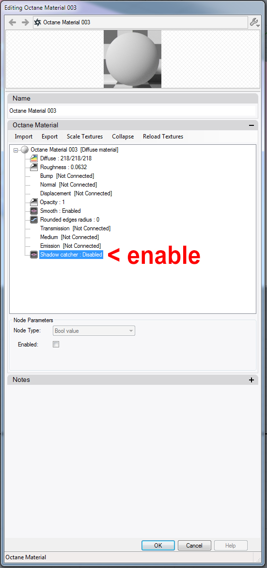

Hi Dottedline,
use diffuse material with shadow catcher enable.
could this help you?

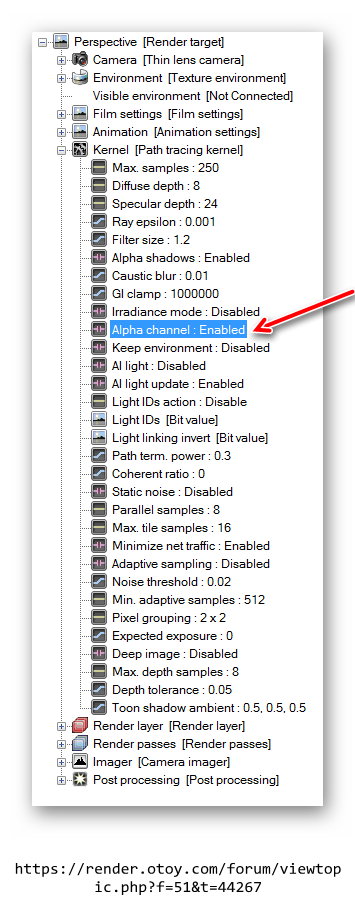

I found you also need to enable the alpha channel in the Kernel tab to get it / save it out.

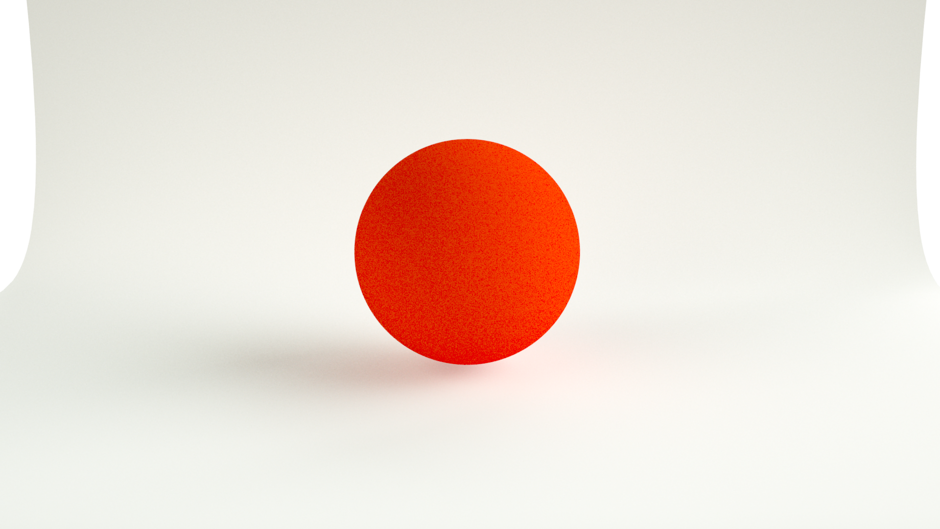

For example on this sample scene there is a white background with a red ball lit by an HDRI. The shadows are soft, subtle red colour bounce etc etc.

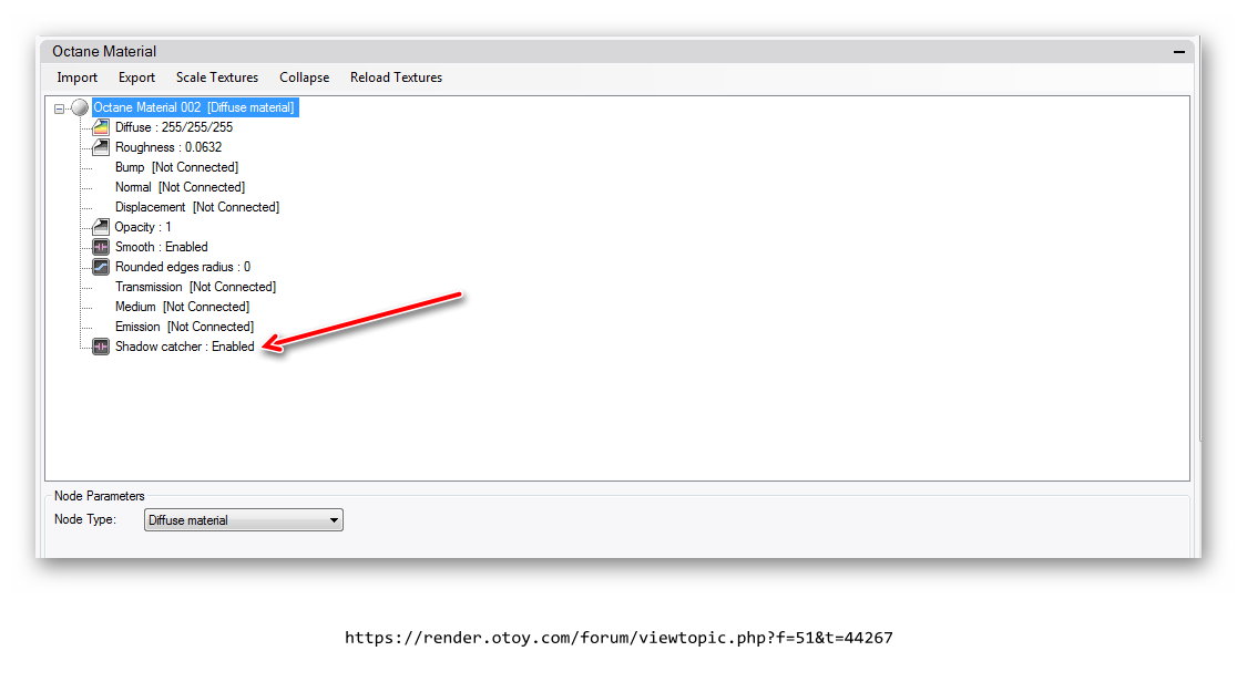

I then change the background to diffuse material, switch on shadow catcher and enable alpha channel in the kernel settings.

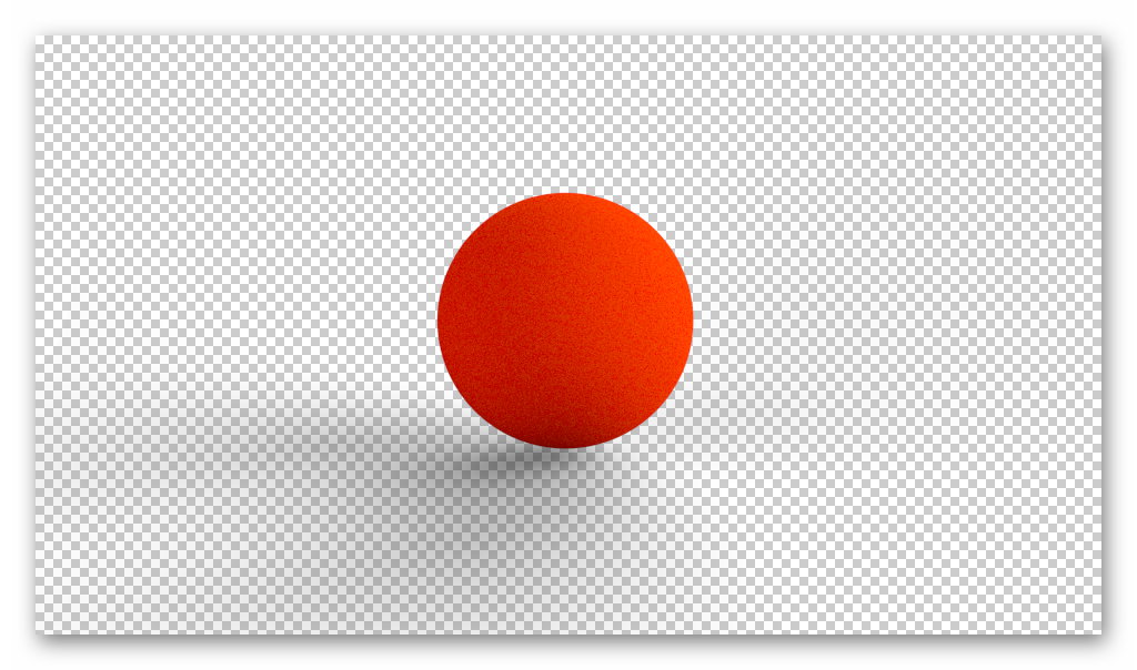

The render show a stark dark shadow, no subtle subtle bounced colour etc but does contain transparency
