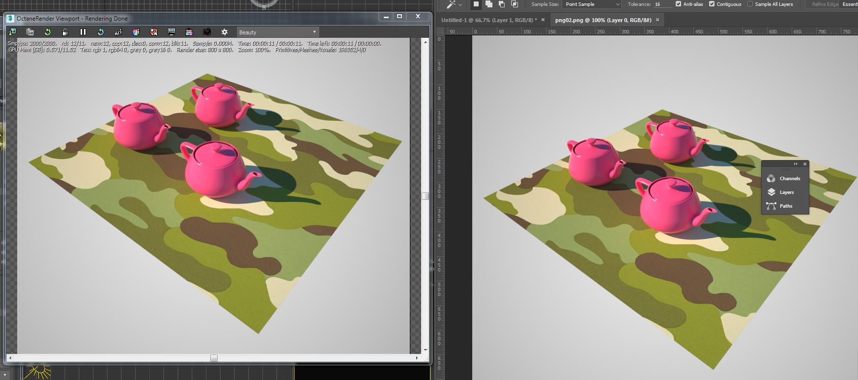

I want to render an image so that when I view it in the OCTANE VIEWPORT and save it to a PNG to give to a client that it looks the SAME as it does in the OCTANE VIEWPORT. And that when the client looks at the PNG in whatever image viewer they use they see it correctly.
After HOURS of screwing around with various settings I maybe have some combination of MAGICAL settings that MIGHT be doing what I want but I am NOT SURE if the result is CORRECT WITH RESPECT TO MY INTENDED RESULT. My settings as it stands are:
1) 3dsmax gamma in it's preferences "Enabled Gamma/LUT Correction" set to ON with Gamma 2.2 and affect everything.
2) Octane 3dsmax gamma hack OFF - seriously WTF is this the tooltip doesn't make it that much clearer?
3) Octane Imager Nonlinear tone mapping ON
4) Octane Imager Gamma set to 1.0 - as to correctly use imager response due to a bug in octane core this must be set to 1.0?
5) Octane Imager Response set to Agfacolor_Futura_100CD
6) Octane post processing off
With those settings if I try and save a PNG various crazy things happen:
A1) If I save a PNG directly from the OCTANE VIEWPORT and set GAMMA to AUTOMATIC (RECOMMENDED) the SAVE DIALOG PREVIEW matches the OCTANE VIEWPORT but the actual PNG file is saved out DARKER than the SAVE DIALOG PREVIEW and OCTANE VIEWPORT when viewed in WINDOWS PHOTO VIEWER.
A2) If I save a PNG directly from the OCTANE VIEWPORT and set GAMMA to OVERRIDE 1.0 the SAVE DIALOG PREVIEW matches the OCTANE VIEWPORT but the actual PNG file is saved out DARKER than the SAVE DIALOG PREVIEW and OCTANE VIEWPORT when viewed in WINDOWS PHOTO VIEWER.
A3) If I save a PNG directly from the OCTANE VIEWPORT and set GAMMA to OVERRIDE 2.2 the SAVE DIALOG PREVIEW is darker than the OCTANE VIEWPORT and the actual PNG file is saved out DARKER than the SAVE DIALOG PREVIEW and OCTANE VIEWPORT when viewed in WINDOWS PHOTO VIEWER.
Now if instead PORT TO MAX FRAMEBUFFER it matches the OCTANE VIEWPORT in the NEW WINDOW that pops up. Then I try and save from that instead:
B1) Set GAMMA to AUTOMATIC (RECOMMENDED) the SAVE DIALOG PREVIEW matches the OCTANE VIEWPORT but the actual PNG file is saved out DARKER than the SAVE DIALOG PREVIEW and OCTANE VIEWPORT when viewed in WINDOWS PHOTO VIEWER.
B2) Set GAMMA to OVERRIDE 1.0 the SAVE DIALOG PREVIEW matches the OCTANE VIEWPORT but the actual PNG file is saved out DARKER than the SAVE DIALOG PREVIEW and OCTANE VIEWPORT when viewed in WINDOWS PHOTO VIEWER.
B3) Set GAMMA to OVERRIDE 2.2 the SAVE DIALOG PREVIEW is DARKER than the OCTANE VIEWPORT AND the actual PNG file is saved out IS THE SAME AS the OCTANE VIEWPORT when viewed in WINDOWS PHOTO VIEWER.
So it APPEARS that B3 MAYBE does what I want and lets the client view the sensibly correct gamma???? If so why can I not simply save the EQUIVALENT PNG directly from the OCTANE VIEWPORT? WHY is this all so CONFUSING? Why does the DOCUMENTATION not make SENSE of this MESS?

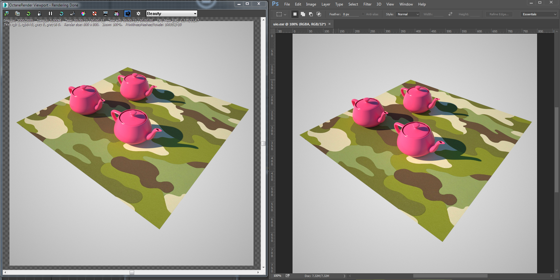

Hi cybernoid,
sample file with linear workflow.
Render saved .EXR 32bit
Regards
Paride
gamma_linear.zip
(755.08 KiB) Downloaded 360 times

Posts: 3992
Hi Cybernoid,
In my scene, save directly to .png.
Does not it work for you?
Paride
