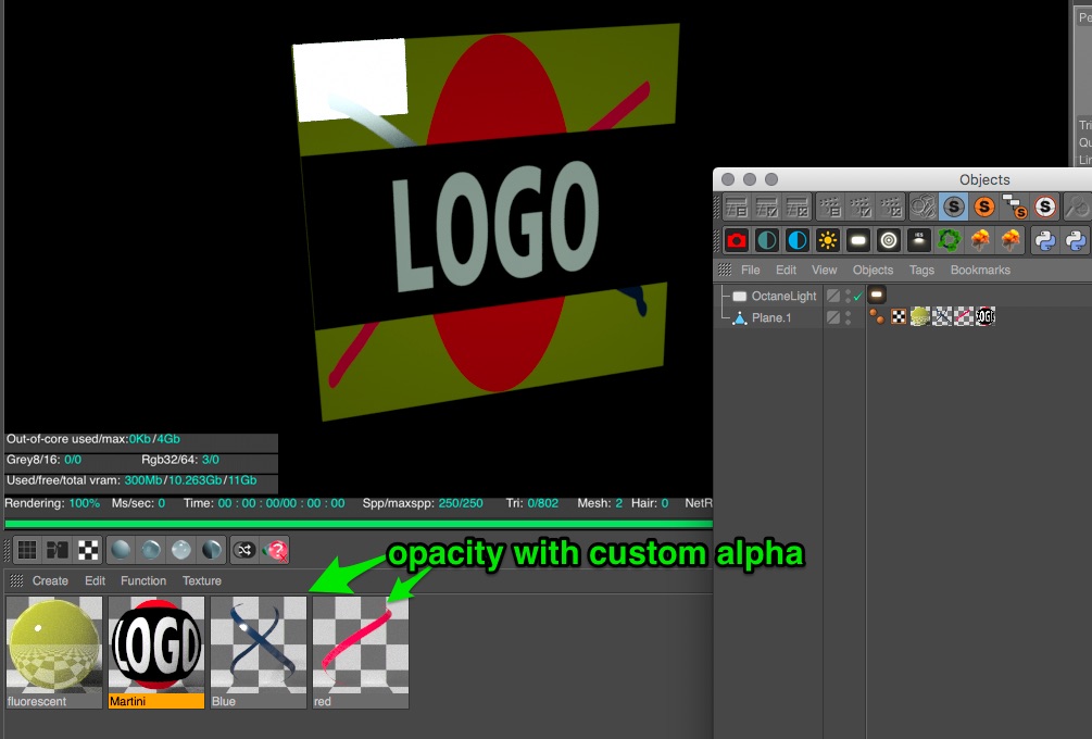

It looks like you're overriding the previous selection tag with the next selection tag.
Could you just add them w/o the selection tags using custom alpha channels on each one?

Thanks for helping out! The selection tags are very specific to the mesh and would be almost impossible to create an alpha for them. Is there another solution to the problem that you can think of? I'm pretty stumped at the moment! :shock:
