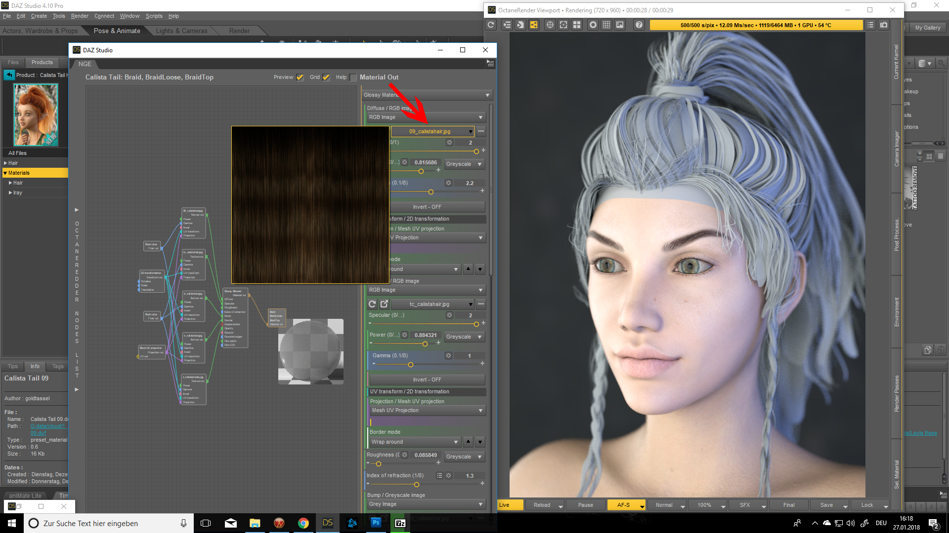

I am having the following problem with some hairs.
They are importing to the plugin with all mats but rendering white. The colors are just rendering if I reload ANY mat for EVERY single hair part in the Node editor.
Has anyone noticed the same problem and is there a way to fix? Its really annoying to to this with hairs that have so much zones :?
I am using Plugin version 3.7.0.37 and DS 4.10.0.123

Hi - have you tried deleting all your plugin settings? Delete C:\Users\[username]\OctaneRender\Data\OctaneRender_settings.oczdb

I dont know why but the problem was that those hairs were installed inside DS with Daz Connect. Those files were in a folder called "cloud".
I have delted all that items and re-installed them manual. Now they work :?:
