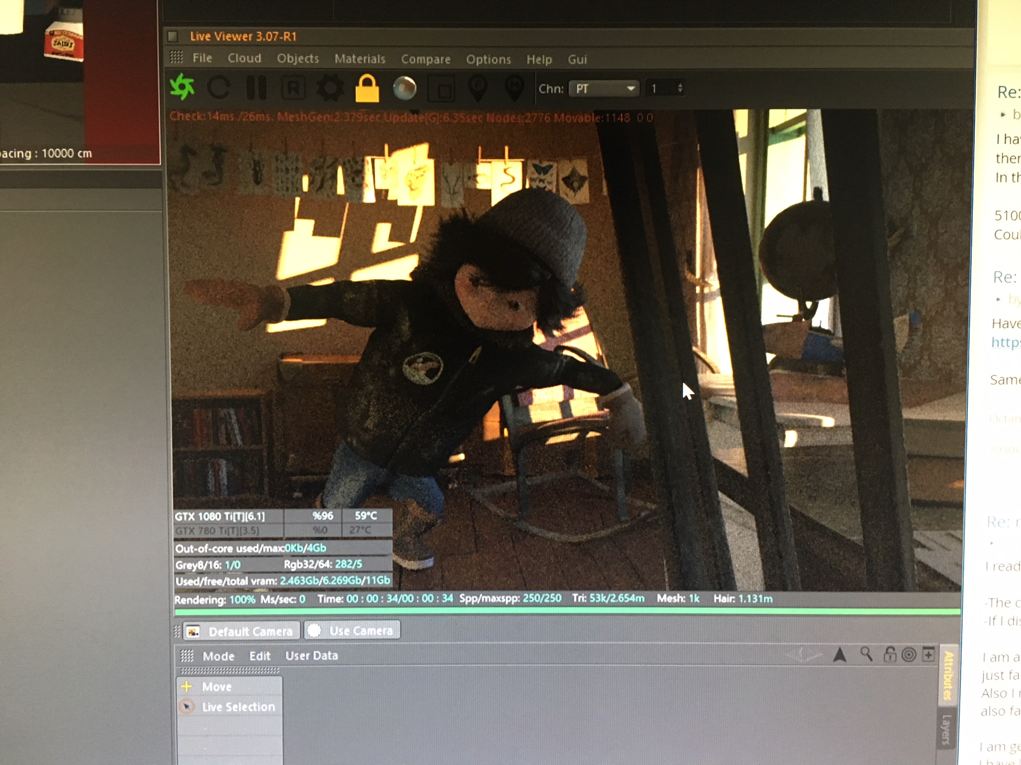

nickyc
Posts: 24
Joined: Tue Nov 03, 2015 12:30 pm
screenshot live viewer
nickyc
Posts: 24
I've got it.
It has nothing to do with the hair.
It is an update issue or preparing thing, the sequence is about 1800 frames long and if I set my beginning time to something like frame 1600 it started to render pretty fast.
Good to know perhaps for other people in the future.
finaly!
