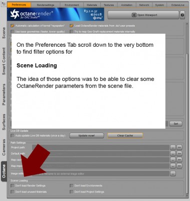

I post this here so that some of the older information how features work do not get lost.
On the Preferences Tab scroll down to the very bottom
to find filter options for
Scene Loading
The idea of those options was to be able to clear some OctaneRender parameters from the scene file.
Scene Loading options
You can place a checkmark in the boxes for
Don't load Rendersettings
Don't load unused Materials
Don't load Environments
Don't load Projects

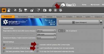

In addition you can use "Manual Mode" to make sure no new material data is created when loading a scene:
Automatic Material updates after content loads is deactivated
Load OctaneRender materials from .duf user presets is deactivated
Manual Mode
Manual Mode
In this manual mode just the geometry is loaded.
Something to test:
If you activate all four options of Scene Loading
Don't load Projects
and are in Manual Mode
In theory that way you removed all the included old OctaneRender information from the scene file and made sure that no new material information is created at loading time of the scene.
Then it might be that when saving a Scene file in this state no OctaneRender information is included.
It could also be that some information is still included nevertheless.
