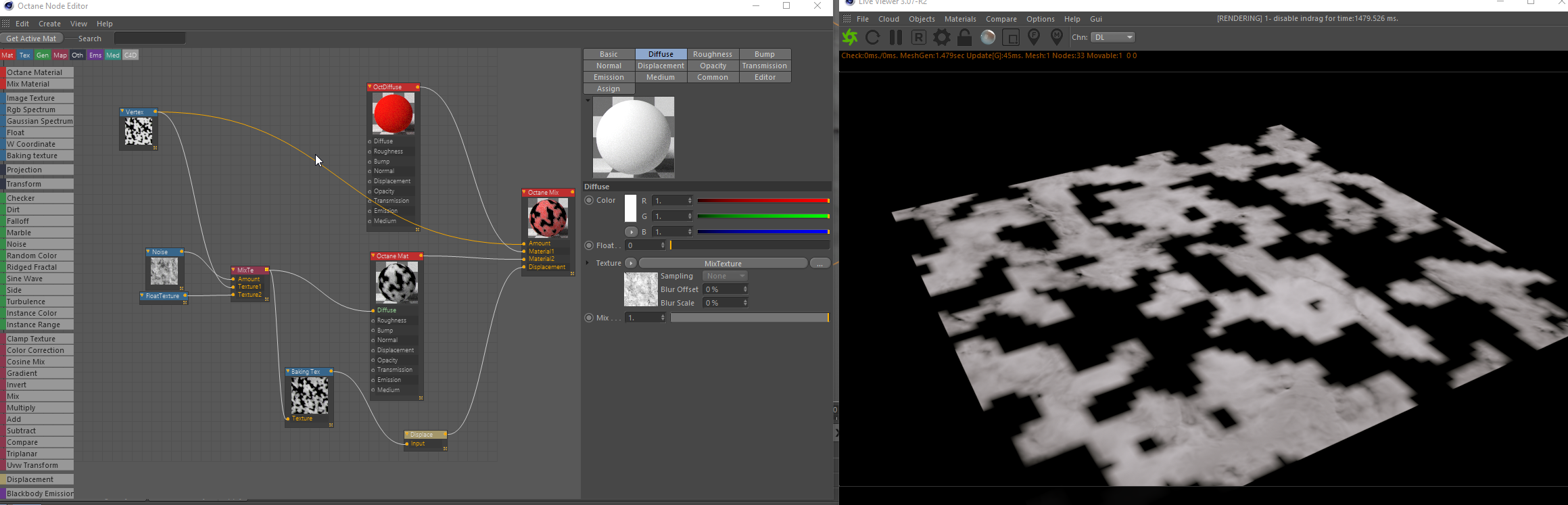

Hi, i wanna do some effects like mixing 2 materials, 1 with displacement and one without but idk how to do it since when i use a mix material the only workable displacement is in the mix slot. Any workarounds? thanks

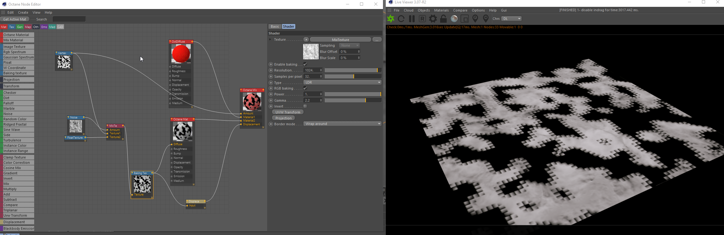

I think i did it proper but it seems that baking texture is giving vertex map some artifacts. Also its very heavy and crashes a lot. Im using latest stable here.

You can't use vertexmap in displacement. And keep away to use c4d shaders as you can. Prefer octane things if you crashes. And what's crashes you say?
In general this scene crashes. Maybe is the vertex map before the displacement as u said.
So whats the way of mixing materials via vertex maps when 1 material has displacement and the other doesnt? ty
btw, vertex map through bake node works in displacement, but i have those artifacts as u see from the baking node. Is this a bug?

BUG is something that doesn't work as promised. Vertexmap is a hacked way which is emulated by plugin and requires uvset3. And octane displacement is not supporting uvset2/uvset3. yw
Open the scene and see thats why i attached it. Try play with vertex map in displacement. It displaces the object but it has artifacts due to baking texture node. And as u will play u will experience crashes.
