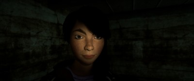

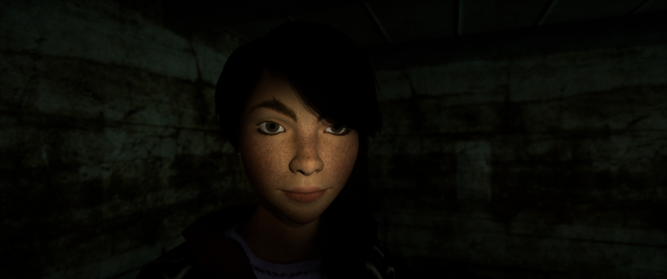

Firstly a quick character lighting test. This was exported as an EXR then graded in Nuke:
The image held together really well in grade. Good responses considering the sources assets and no complaints.
