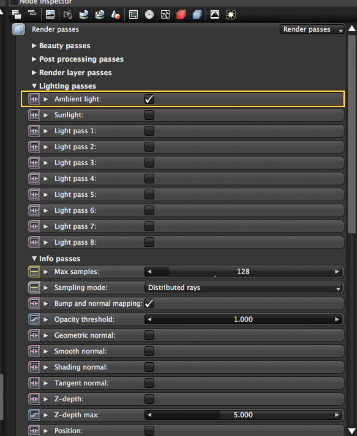

I have an Interior scene lit by an HDRI Environment map and artificial lights. I use 2 light passes for the artificial lights for PP, can I also get a light pass for the light which is contributed to the scene by the HDRI Environment?

did you try to enable the Ambient light pass? ciao beppe

that was exactly what i was looking for .... so many passes ...must have missed it
