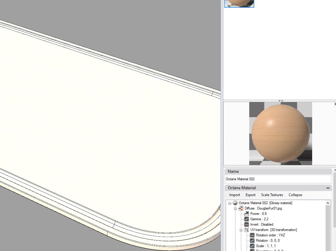

I´m havin some problem when trying to mapp the texture´s.
Basicly, im not seeing the the texture when trying to map it.
Am i missing some setting that can solve that problem?

Hi almfeldt,
I'm not a Rhino expert, try:
in Rhino viewport drop down menu set "rendered", than Render > Render properties > Rendering > set gamma 2,2
it should solve your issue

Do you mean not seeing the texture in the Octane render viewport or the Rhino render viewport?
If its for Rhino viewport it could be the view settings are not set properly.
Options > View>Display modes>click on rendered>click on default.
Try that first.

Thank you, that did the trick, changed the gamma value and now i´t works perfectly.. :)
