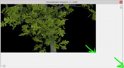

I am having troubles with the material pick pointer (in plugin version 21). It does not select the material when I pick a point in the OR Viewport. I do have to select the object in ArchiCAD to edit the material setting.
Anyone knows what might be happening or also having problems with that or am I solo on this?

This is happening on all... And On all screen of viewport.
When i pick a material on the viewport it just picks another one that seems to be above it or something.
Then I have to pick below or right of the material to get it... Looks like all is scaled virtually.

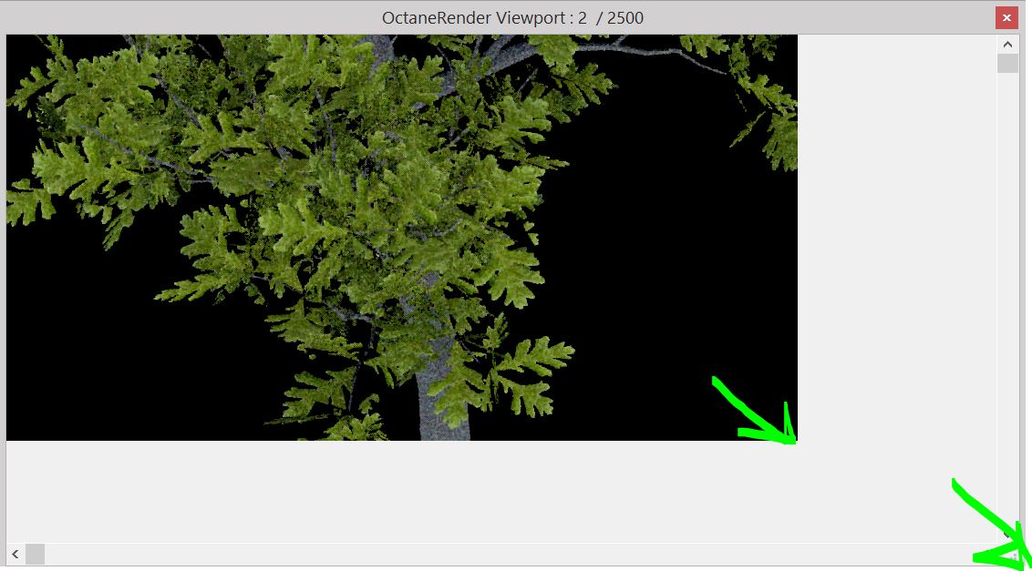

Now I notice that the Viewport shown is actually always scaled down to the actually Viewport window?
When I make the Viewport bigger or smaller, the shown viewport scales with it always being smaller.
That explains my feeling of sclaed mistake when using the material pick point.

Thanks Jeroen - I will try to fix this in the next release. For the moment, unclicking Resolution Lock should allow you to pick materials.

Unlocking the material picker does not make the material picker work correctly, because the render is scaled wrongly in the viewport.
It is very hard to work properly this way...
