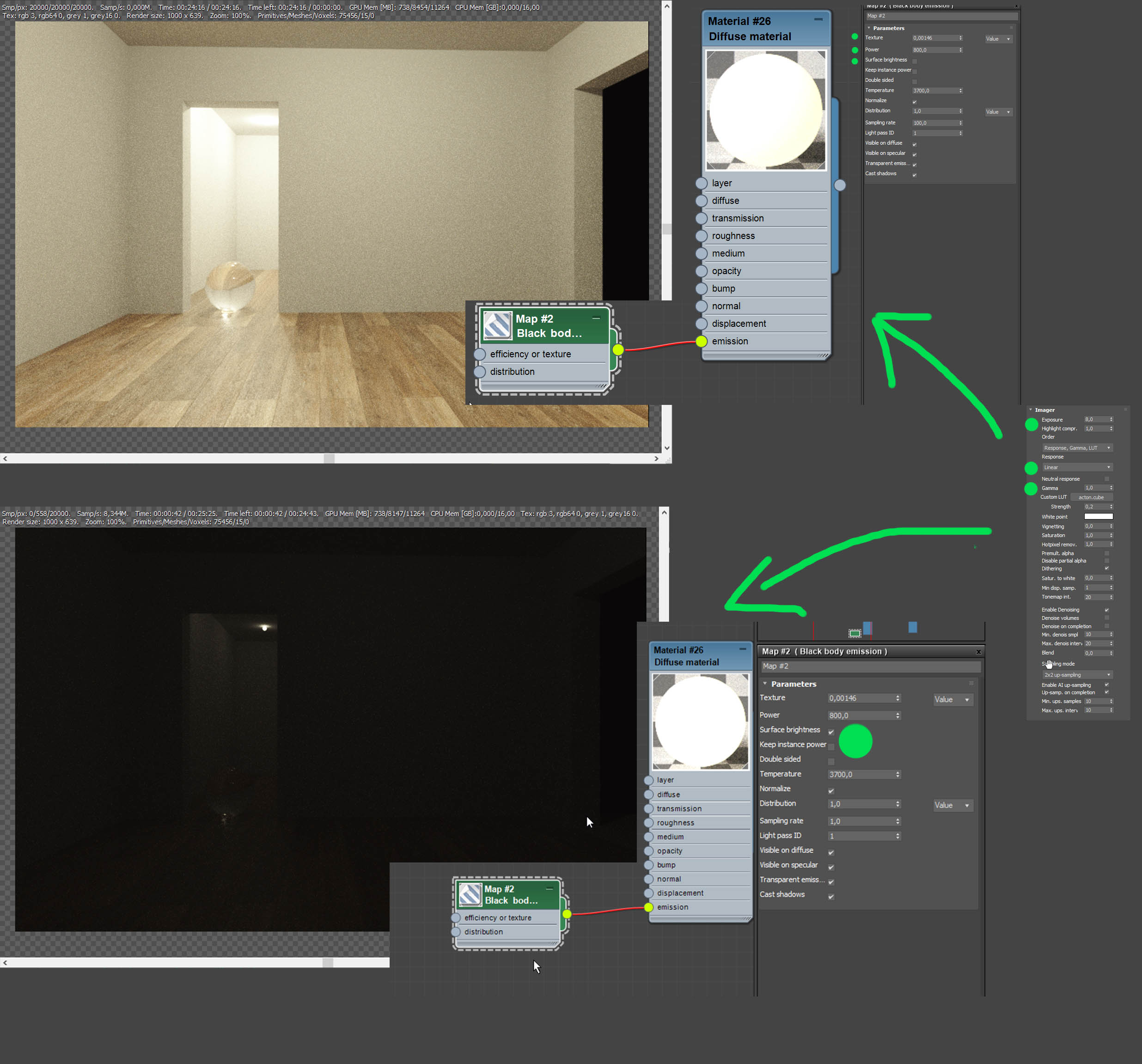

I can't be sure about surface brightness. For example I use a circular surface for spot light. I set power to 850 lumen and effiency to 0.0014. (viewtopic.php?f=9&t=62045&p=329618&hilit=lumen#p329618) But when I leave surface brightness disabled it is not looking right. Light seems very strong for 850 lumen.Circular Surface' diameter is about 8-10 cm for example.
When I enable surface brightness option it is very dark.
What is the right way for this situation?

it is quite normal to have a very dark scene with 850 lumens, it depends on camera exposure.
Octane camera has not iso and shutter, but we can consider exposure 1 like 100 ISO in outdoor with midday sun.
you should consider shutter too, but let's keep it simple... so with 850 lumens (lightbulb around 60 watts) in a room, I think you should adjust exposure 8.

thank you for your reply. I know I can increase exposure value like a real world camera. My problem is octane light emission's surface brightness option. I can't be sure that I must enable or disable it for a real world light simulation.
When I say "it's very dark" I mean when I compare real world shots with same lumen light sources it doesn't look right.

Hi wisemanxxx,
correct setting is surface brightness ON.
very dark response, I think right; when you take a shot in real life, your camera increases shutter time.
If you had an analog camera, to shot a room with a 60watt light bulb, you should have about 800 ISO and sutther speed about 1/30s or 1/60s with openings f/5.6.
In Octane f * is for depth of field, but not for brightness; so to get a right shot you need to increase exposure.
Regards
Paride
