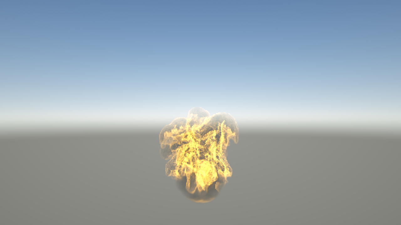

I am trying to play around a little with volume geo in octane. I made a simulation in houdini and exported it into a vdb sequence. This i then added to the octane volume node. The only problem is that i can only controll this thorugh the octane viewport. Which is understandable. But how can I make it animate with the recoding of the unity recorder? Cause right now I have only been able to render out the animation from the batch rendering in Octane viewport. And when I Render in Unity it is stuck in the first frame of the volume sequence.
So basically my question is:
is it possible to use the recorder in unity and also update the volume frame sequence along with it.
This is the result of the batch rendering in octane viewer:

Ill see if we can add setting octane time with the recorder.
