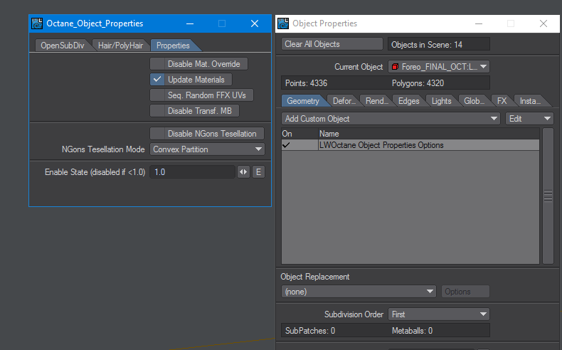

Hi Chris,
I assume you use LW ? If yes then there is option to do that, in object properties (i'm using it for current project right now ;)), You add "LWOctane Object Properties Options" unde Add Custom object TAB to desired layer/object and then in render target you enable "only materials in enabled obj."
