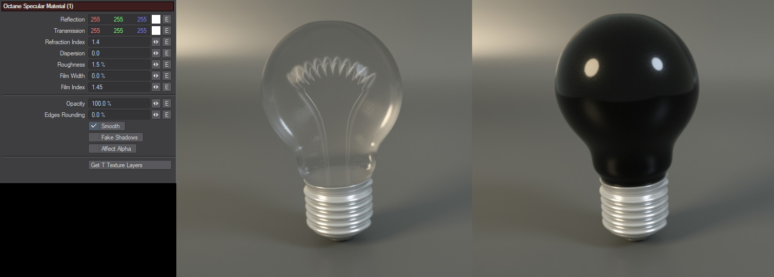

I have a question that is pretty simple but is giving me quite a headache (Yes I'm new to Octane)
I have a lightbulb and am having a hard time creating realistic glass with it. I have included an image that shows how the glass looks like a solid bulb, which isn't what I want. But when I go into modeler to give the glass two sides (roughly 1mm thickness), suddenly my surface goes completely black, and I don't know what is causing this to happen.
Thanks to anybody who can help me!

You could try increasing your Specular Depth inside your kernel.
juanjgon
Posts: 8867
Location: Spain
Also, check the kernel ray epsilon parameter, perhaps it is too big or small for this scene.
