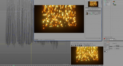

I have a trouble trying to get xpTrails in Picture Viewer (LV shows them Ok).
This problem occurs just in case of caching Emitter with with NO cache on Trail object - this is propper setup for interpolating particles and trail movement in slow motion via Cache Playback options.
There is no problems in PV with no cached objects or cached Emitter+Trails in real time play.

Still here is no one who use time remap with XP + trails?))
Have tried Sweep object on trails with the same result - LV shows trails geometry, PV has none.

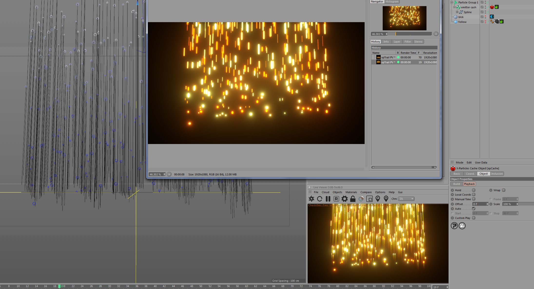

Did you find a solution to your issue? I am facing the same problem, when I cache my emitter and use retiming I have a delay between my particles and my trails... I am finding no solution and I need to use retiming for my client.
Any help/solution on this one would be much appreciated!
