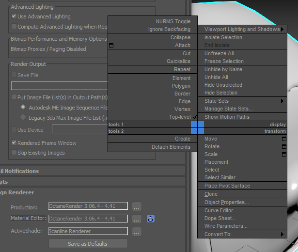

I recently discovered that "Octane Properties" is missing from my context menu when I right-click scene objects.
Any thoughts on why this might be happening, and how I can get it back? It's making it difficult to enable motion blur on a project I need to render today.

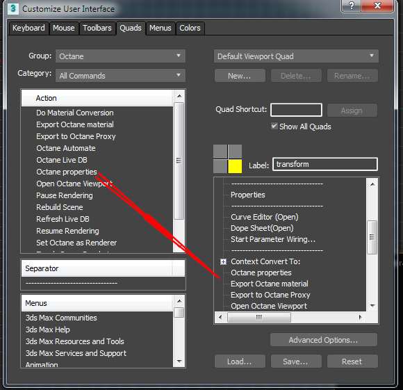

Go to 'Customize User Interface' then click on the 'Quad' tab. Under 'Category' choose Octane then drag and drop each item into the panel at the bottom right.
If you do this just after you open max then save over your maxstart file then you won't have to repeat these steps again.

Yes, THANKS!
I've noticed Max to seemingly overwrite my preferences randomly, so actually did dig through the "Customize User Interface" settings, but didn't think to check if Octane had its own group outside of "Main UI". Doh!
