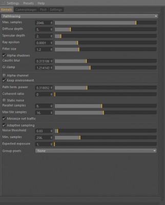

I'm preparing some files in c4d to render as animation under octane 3.07-R2.
I did a test, and was surprised it took +-2 min per frame to render at 1680 x 1050 pix, pathtracing (see details in attach)

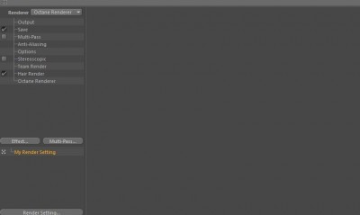

- In my render setting I have checked also the hair render, because of the character in my file. Is this ok in combination with the octane render? (see attach)

- What is the best option for animation, direct lighting or pathtracing? (see attach)

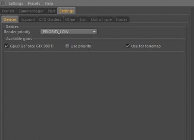

- Are the settings for the render priority correct? (see attach)

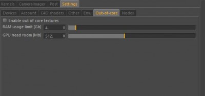

- Do I have to select or change something at the out of core menu? (see attach)

Disable hair render from vpost. You don't need it and it will cause to run c4d before octane.
