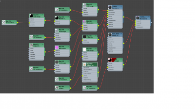

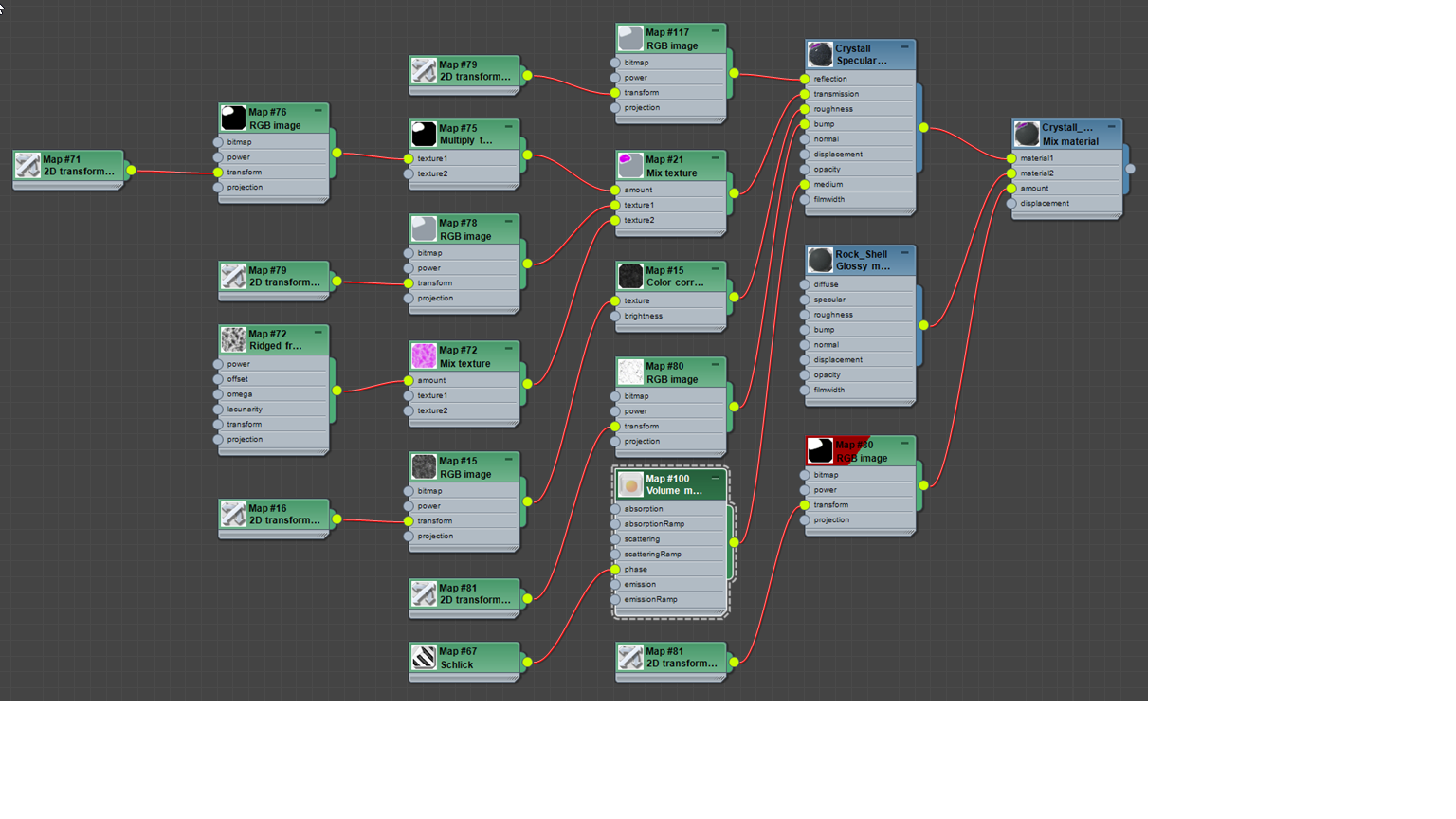

The material setup is like this:

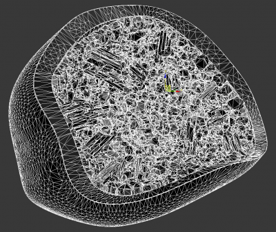

And this is the mesh.
The mesh is fully enclosed for the sss to take effect. (As far as i know you need encloused mesh/volume for the sss to work correctly right?)
But its a bit detailed, can that be a problem?
It can be a bit hard to catch the noise at first since the animation i have posted here is a bit short and fast. But if you play it in loop you can see these bigger splotches of purple innside the crystals that really goes crazy.

This is embarrassing. was not flicker at all. wasn't the SSS either.
I had a Ridged fractal texture controlling the amount in a mix map.
The ridged fractal texture was maped in worldspace so when the object was moving trough space the texture was standing still and by that not following the object resulting in this strange looking flicker.
But in reality wasn't flicker at all, just a texture that looks like it moving.
