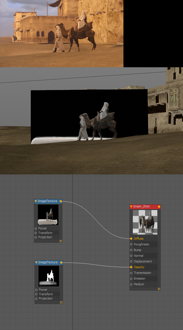

Isn't it possible to see opacity in Cinema 4D viewport?

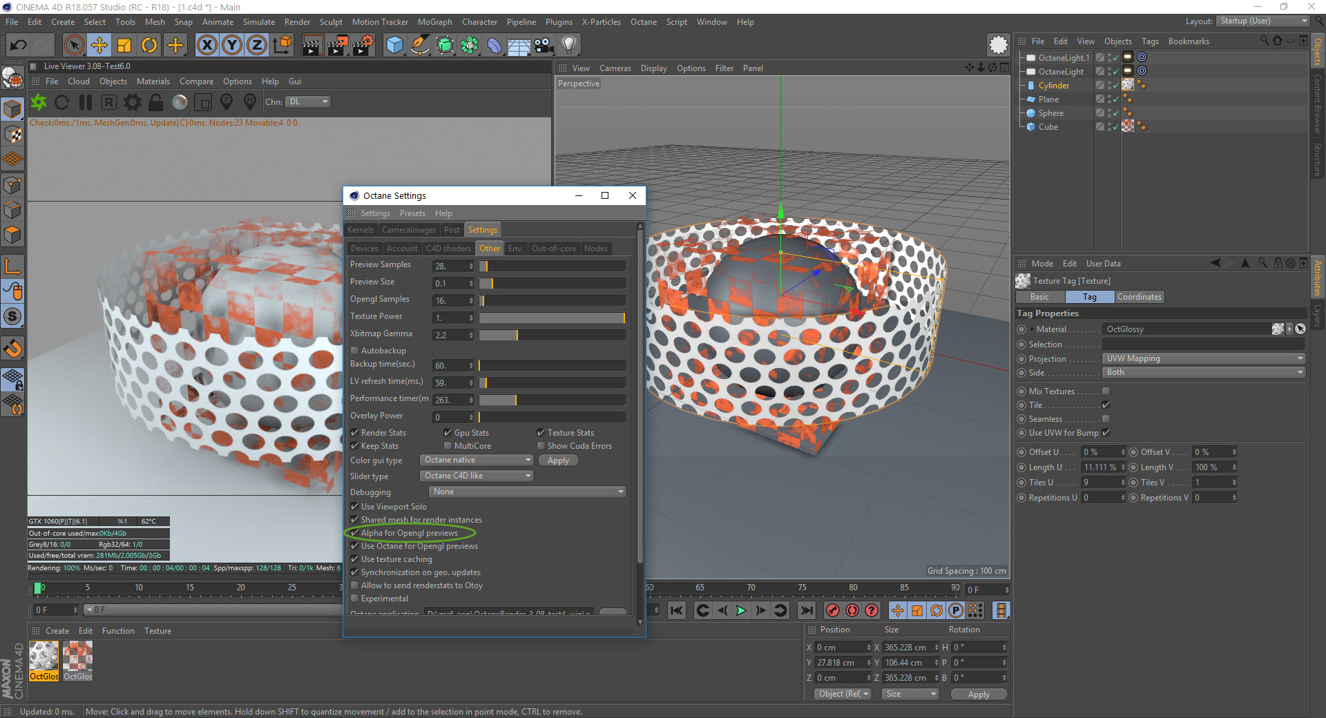

Yes! But it may cause some problems. Try activate "Alpha for opengl previews" and restart C4D. It's not working well on some cases due some problems on C4D SDK. It's why i disabled by default.

Hi folks. I still have this issue on every project. No idea how to fix. Using c4d r25 and octane 2021 1.5 and yeah same thing. textures with a matte used in the opacity channel just show the cut out area as black. really inconvenient as i cant see my scene in the viewport properly.
