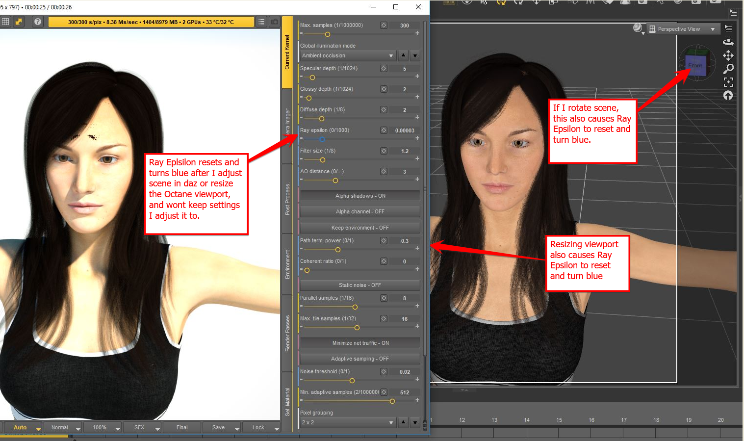

After changing the Ray epsilon value in Daz for Octane, the setting keeps resetting itself if I adjust the scene in Daz or resize the Octane Viewport window.
Also the Ray Epsilon slider turns blue after it resets.
(I'm changing the value because of the texture issue on the forehead.)
Here's a video demonstrating the issue: https://jasonF22yahoo.tinytake.com/sf/M ... 82NzUyNzkx
Also included a picture with explanation

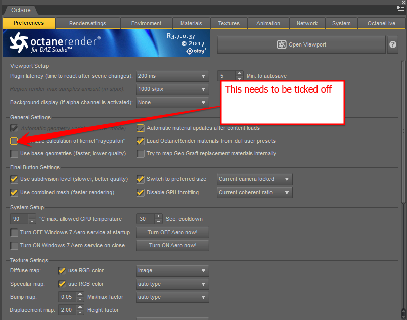

Ok never mind I found the answer in this post viewtopic.php?f=44&t=60895
The "Automatic calculation of kernel rayepsilon" needs to be unticked
