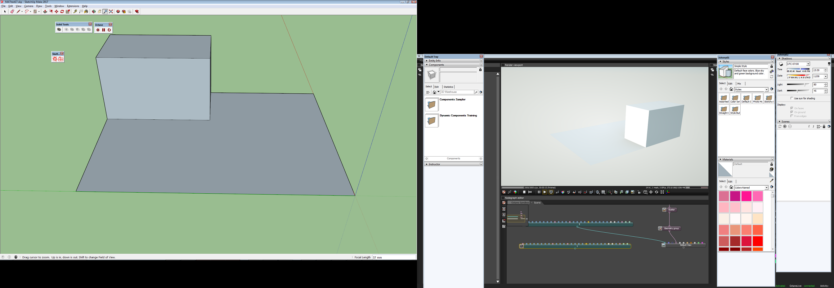

This is a powerful request, especial if combined with only edited geometry get updated in Render viewport. It's like a dynamic render region (c4d has it if i remember correctly).
Look at this (what c4d had 3 yers ago :roll: )
http://lesterbanks.com/2015/05/realtime ... ctane-c4d/
Right now u could do someting like this....
U can walk aroun in SU while octane render, but if update anything >render restarts
best,
Johnny
