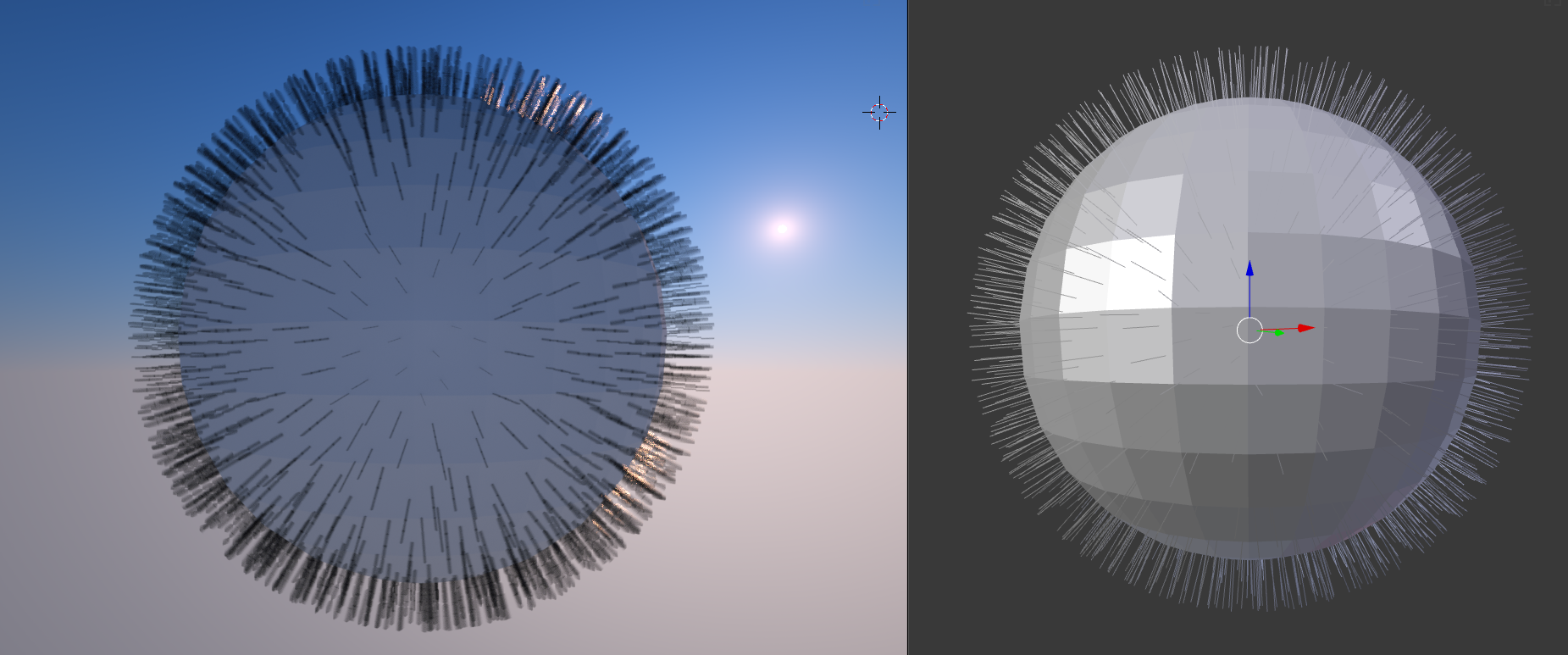

See attached picture. Renders as thick, aliased and blurred lines. In 12.xx it was ok.

Thank you for bringing this to our attention. I will test for this in the upcoming version. We may need to defer this to the next version - if it is a simple fix, we can make a hotfix for it asap.

I've found a solution. You need to Apply scale to the object and it will be back to normal.
