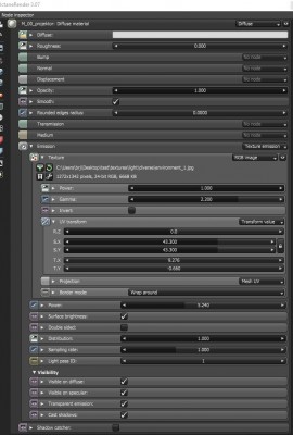

i'm trying to project a texture in the standalone, but can't figure out how to. the tutorials i can find are for maya or cinema4d like this one from calus
viewtopic.php?f=126&t=61224&p=313218&hi ... or#p313218
i've also had a look at this thread
viewtopic.php?f=28&t=63611&p=324608&hil ... ma#p324608
where renart mentions that jama is using the projection method to create some interesting shadows.
i have tried to add the texture both as texture emission > texture > rgb image and as black body with a texture and with a texture in the dsitribution map.
can any one link to a tutorial for this in the standalone?

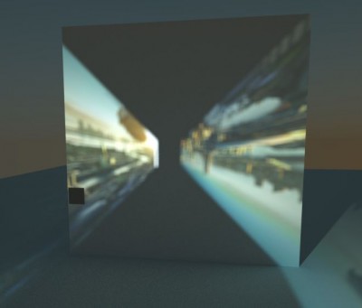

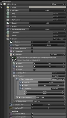

Well i came a bit closer now - following this toturial by Eric J Creations
https://www.youtube.com/watch?v=3IVCXIuHDeo
it seems that the projection should be perspective, and then use 2d transformation.
but my images seems to somehow split int the middle - doh and why?
btw this one is done with the sketchup plugin, as i use sketchup to model - could that be the problem?

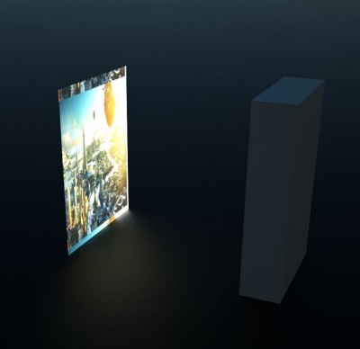

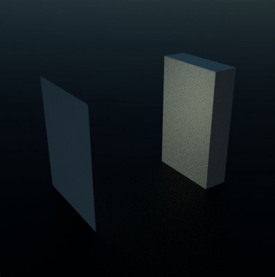

well i tried to model the same in revit, only difference - the light was a box - and i worked.
i then modeled a box in sketchup and it worked :-)
