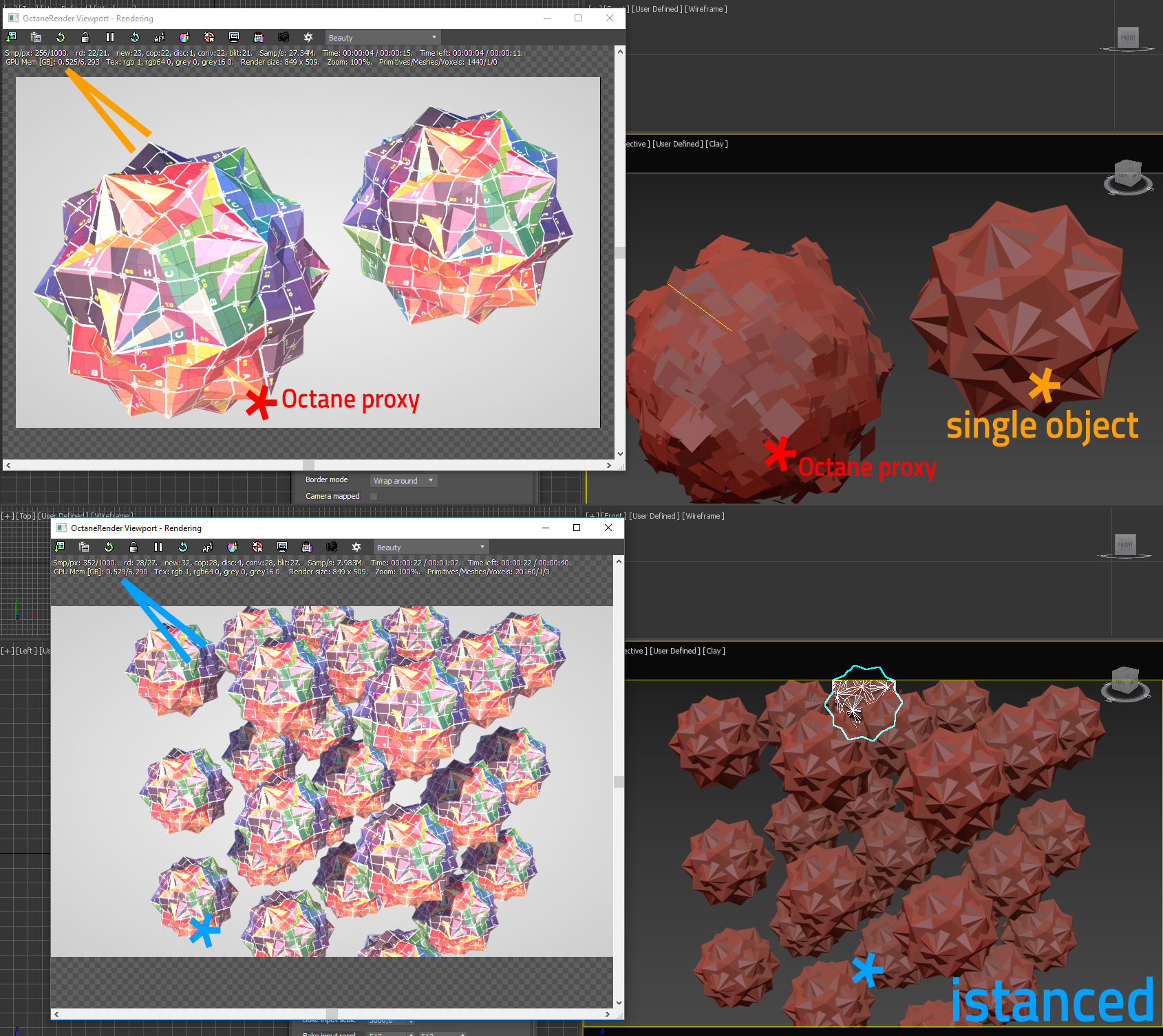

Hi jamestmather,
I do not find issues about size or textures using Octane Proxy.
As you can see, VRam remains the same using object instances
https://docs.otoy.com/3DSMaxH/3DSMaxPlu ... ht=movable
Regards
Paride
Regards
Paride

- paride4331
- Posts: 3985
Hi jamestmather,
Re-texture or Resize is not necessary, Octane proxy has textueres and size.
I do not understand, could you share some screenshots about your workflow and these issues?
Regards
Paride
Regards
Paride
