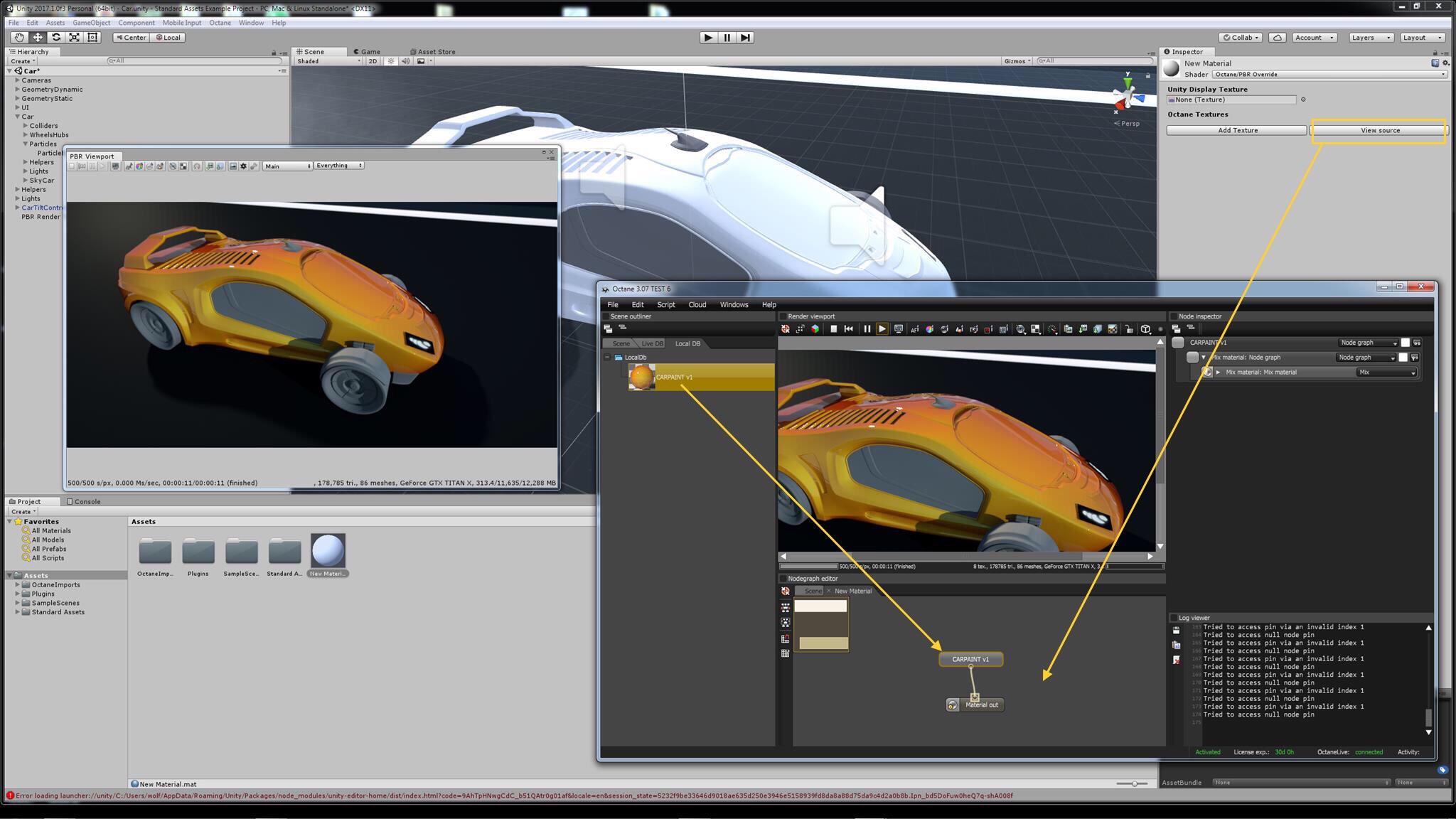

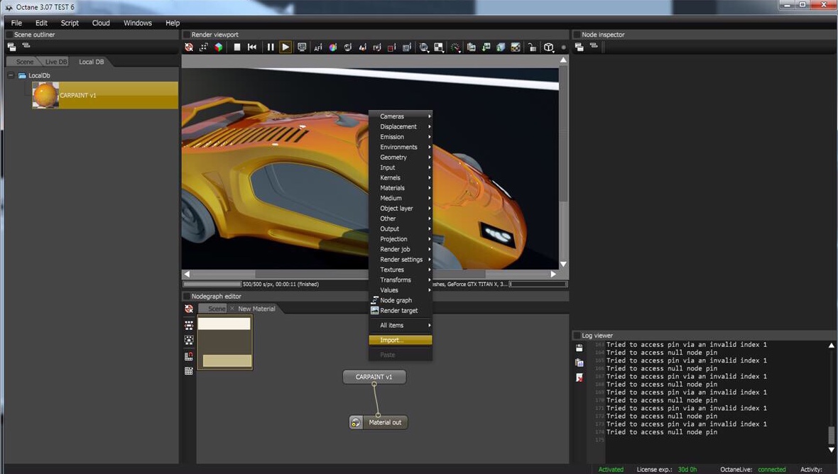

you can save the materials in c4doctane (or any other plugin) within the LocalDB, then import the materials back into Unity from the localDB, and use the materials with unity objects, in source mode:
Or import the single material saved as .orbx, by right-clicking in the node graph editor, always in source mode:
