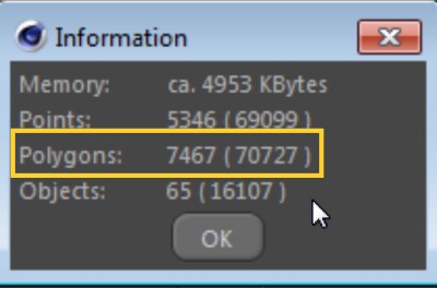

Note that in c4d Project information panel (Ctrl+I), you can have an idea of the polygon count in both LV and PV:
On the log, it is possible to have all these info, and correct the geometry subdivision, or textures resolution, depending on the scene.
