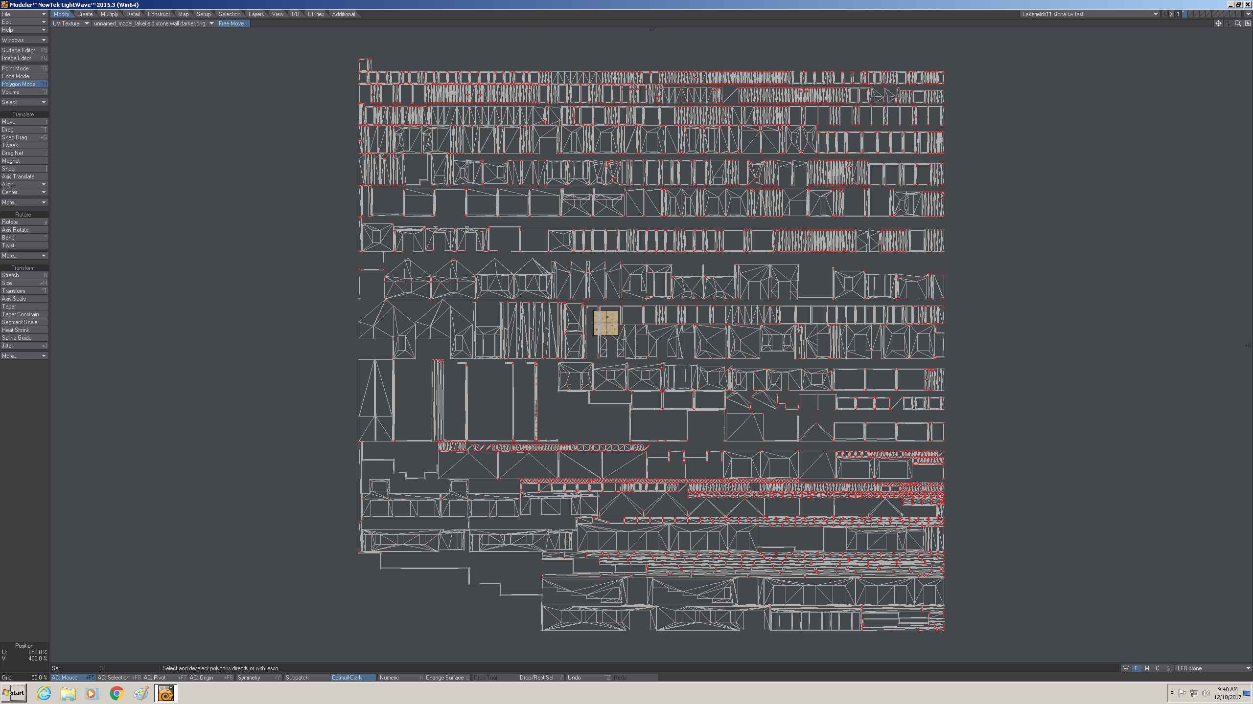

UV map for camera. this tile works
Any way to use tiling on a uv map in the baking camera?
