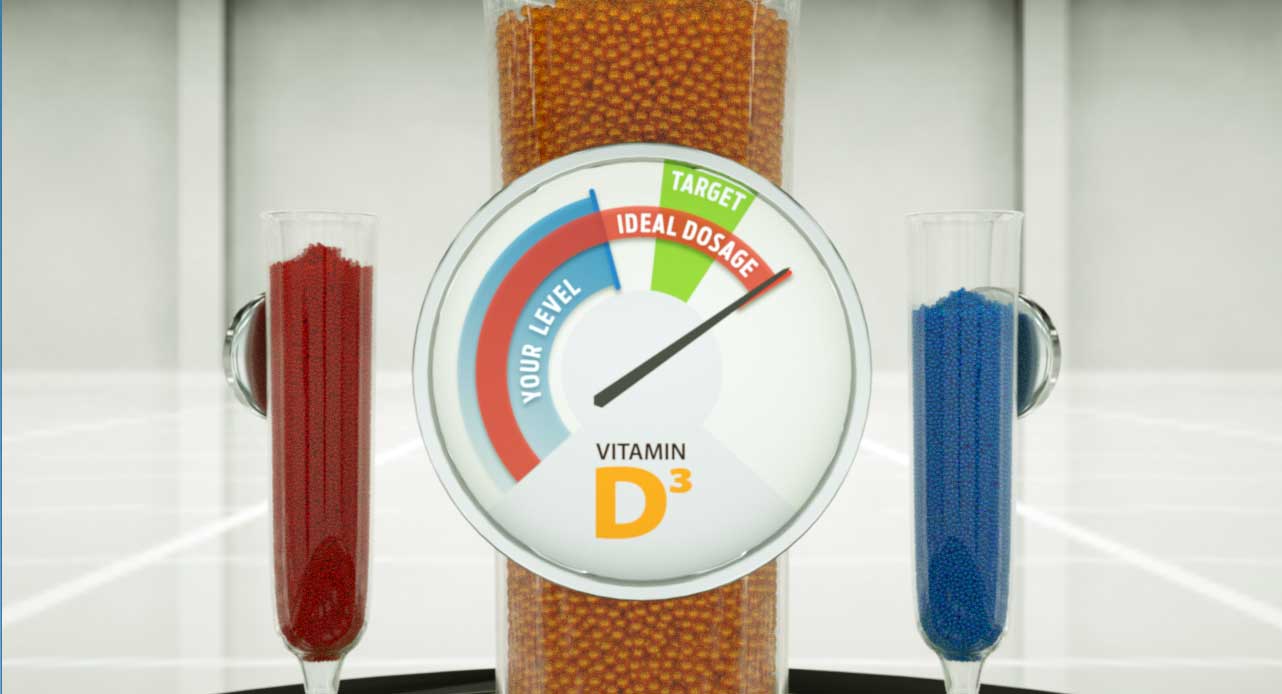

Here is what I am seeing.
This is straight from the ROP either IPR launch from the ROP or render frame to disk from the ROP.
