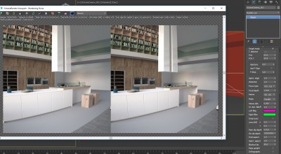

Hi LIANNYEE,
take a look at the attached screenshot and refer to the Octane 3dsMax manual plugin
https://docs.otoy.com/3DSMaxH/3DSMaxPlu ... 0by%20side
Regards
Paride
