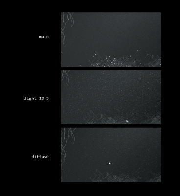

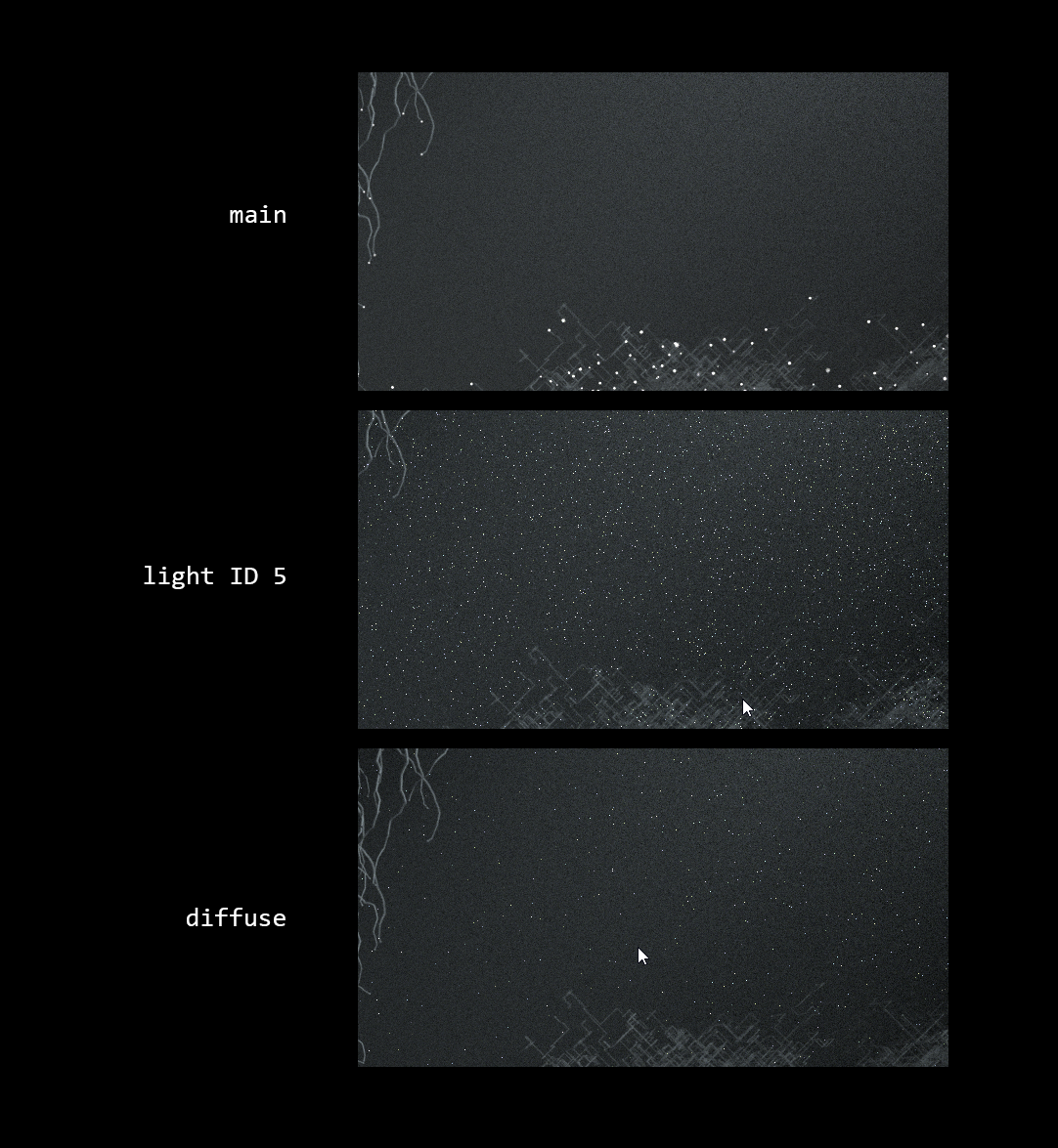

Single image: no fireflies (Scatter medium on an environemnt, and a light. )
Multipass: diffuse and light ID have many fireflies

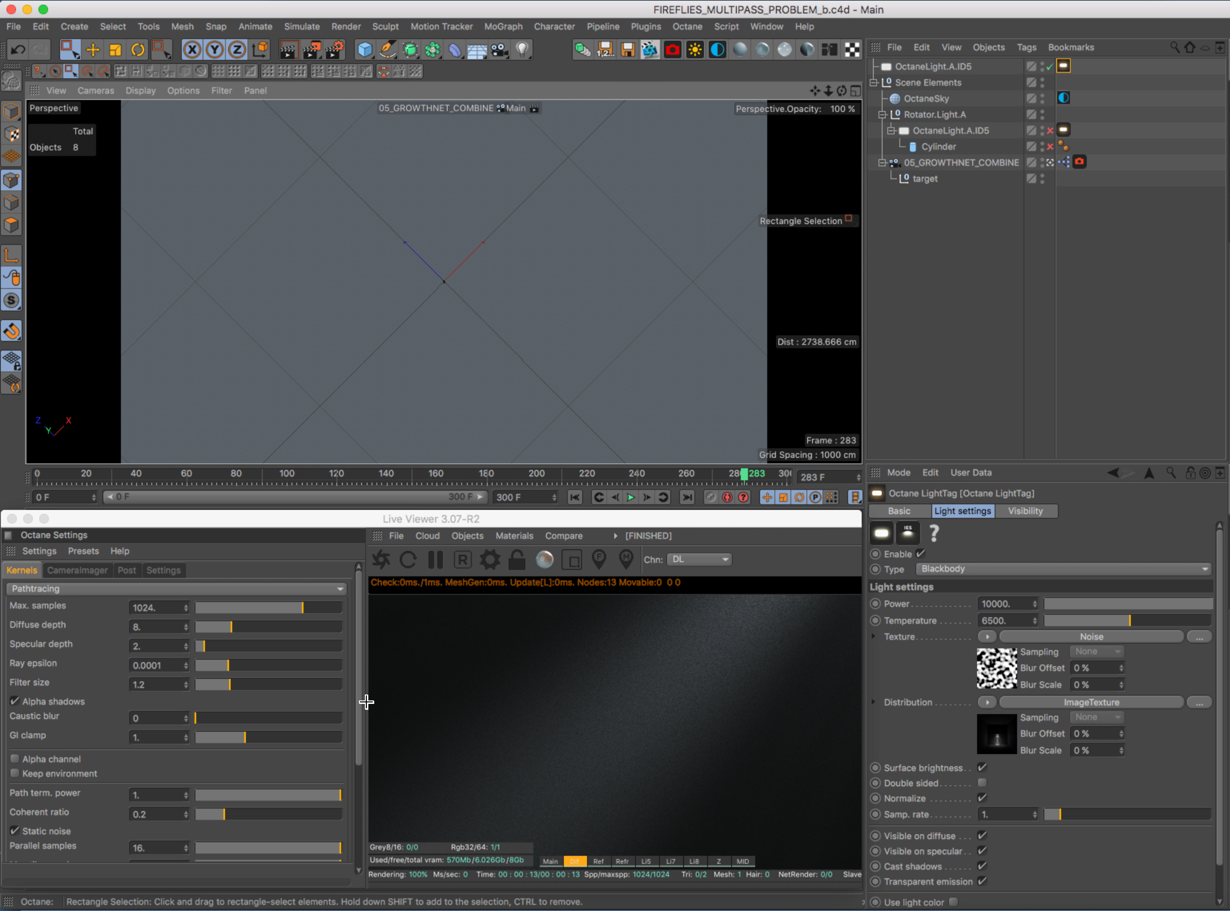

In Octane Setting > Camera Imager > hotpixel removal at .82 (no fireflies at this hotpixel setting)
Enable the scene camera's imager, put the hotpixel removal setting all the way to 0, I get less fireflies in multipass but still not not a good image.
What is the best way to deal with hotpixels in a multipass workflow?
Render passes have fireflies, beauty has none

Hi vmedium,
hotpixel removal is a post effect, so it is not good with multipass.
In your scene, the fireflies are generated by the recessed light you have built. This is always the worst scenario for Path Tracing rendering, please, have a look at this other discussion:
viewtopic.php?f=23&t=52982&p=266457&hil ... er#p266457
Here is your scene with your light replaced by a simple plane with IES file in distribution: As you can see, in diffuse pass there are no fireflies, and the Hotpixel removal can be set back to 1.
Note that in the light passes there are still some fireflies, since they are intended to be mixed with other passes, and the fireflies will not be visible.
Anyway, if you need a clean pass, you can render at double resolution, but with a quarter of max sampling for the same time, and downscale at the original size, to kill any one-pixel firefly.
Here is the scene file: ciao beppe
Thanks for the scene. The problem is that GI clamp is applied only to the light passes, which will be fixed with the upcoming 3.08 test 5 release. The diffuse pass should actually be empty and the scattering of the environment medium should be in the SSS pass. And I don't know yet why GI clamp isn't applied to it either, but we will try to fix it as soon as possible.
