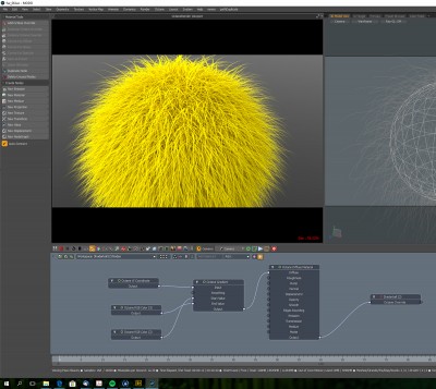

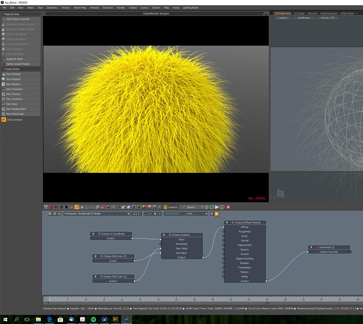

Here is my result of wcoordinate ... or I`m doing it wrong ?
My modo is 902 (108604) octane Standalone (3,07) Plugin verison (3_7_0_125).

Hi. The W Coordinate only works on Octane hair strands, and in your scene you have the render cache turned on, so Modo is converting the Fur Shader polygons. So you need to apply UV's to the Modo generating geometry (unsure if this is possible or not), or convert the Fur Shader strands to curves so that the plugin can render them as hair strands.

Well Paul I was afraid of that. Converting fur to geometry is painful in modo. Thank you very much.
