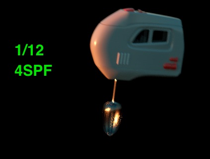

Actually im attaching a test scene cause i cant get it to work with a helicopter kind of thing. It gives me mblur in the body but not on the spinning parts. I could use some assistance. Ty

you have an octane tag on the body, but not that blades, that's why you're missing blur on the blades.
I moved it up to the top 'Mixer' null and it works fine.
you can adjust the time sampling per frame in the render settings as well.
https://docs.otoy.com/Cinema4DH/C4DPlug ... ion%20blur

Oh thank u so much, i didnt know i have to use tags to the objects i need mblur. Is there a global option for this? thanks a lot
