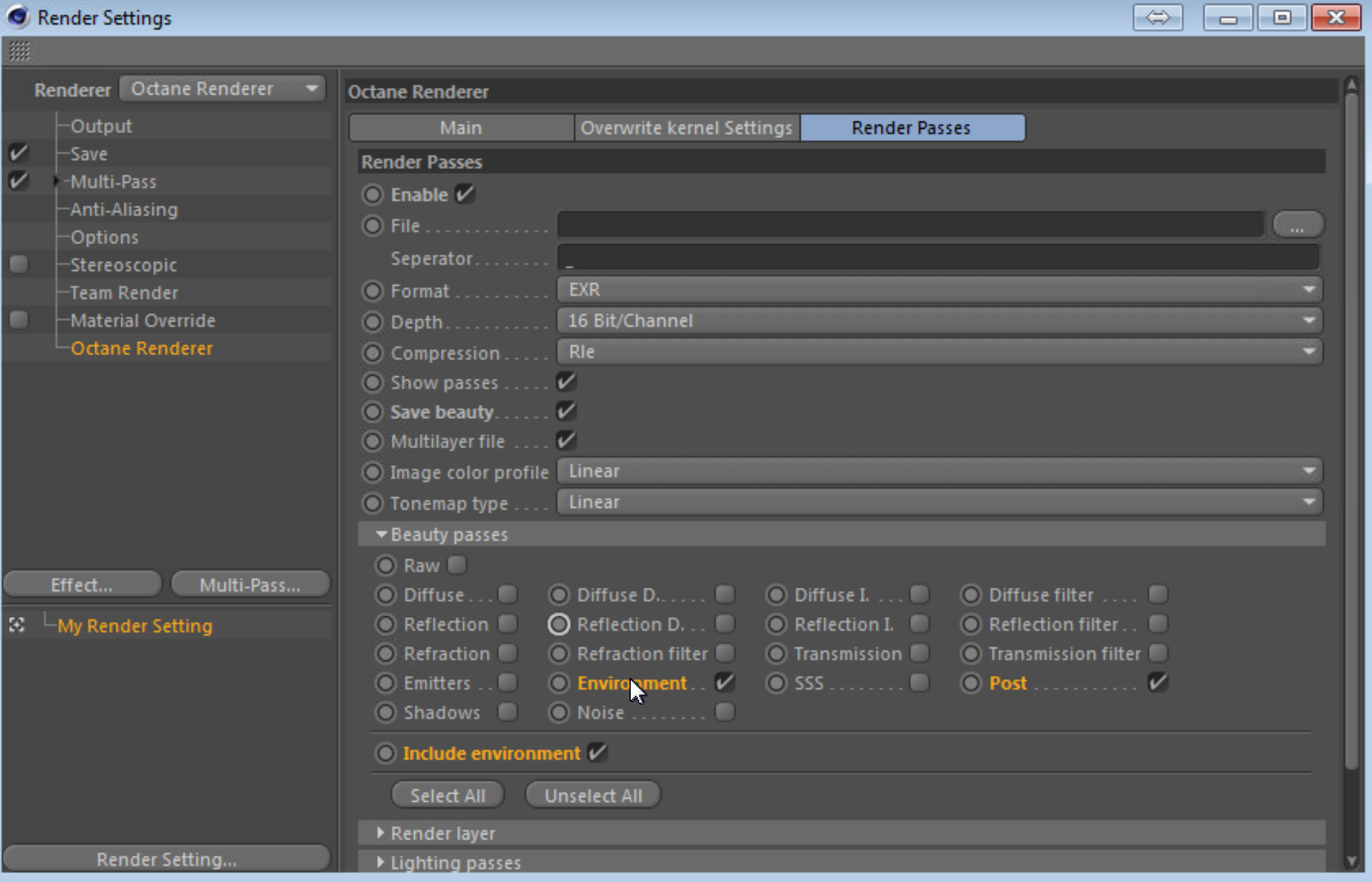

Hi miohn,
you need to enable the Render pass Environment, and post layer, and tick the "Include environment" option:
ciao beppe

thanks Beppe,
so it can only be rendered via render-passes and not
with the normal "c4d-save"?
regards
Mike
Posts: 10563
please, have a look at this xpresso for an alternative workflow with Background images:
viewtopic.php?f=87&t=63808
ciao beppe
