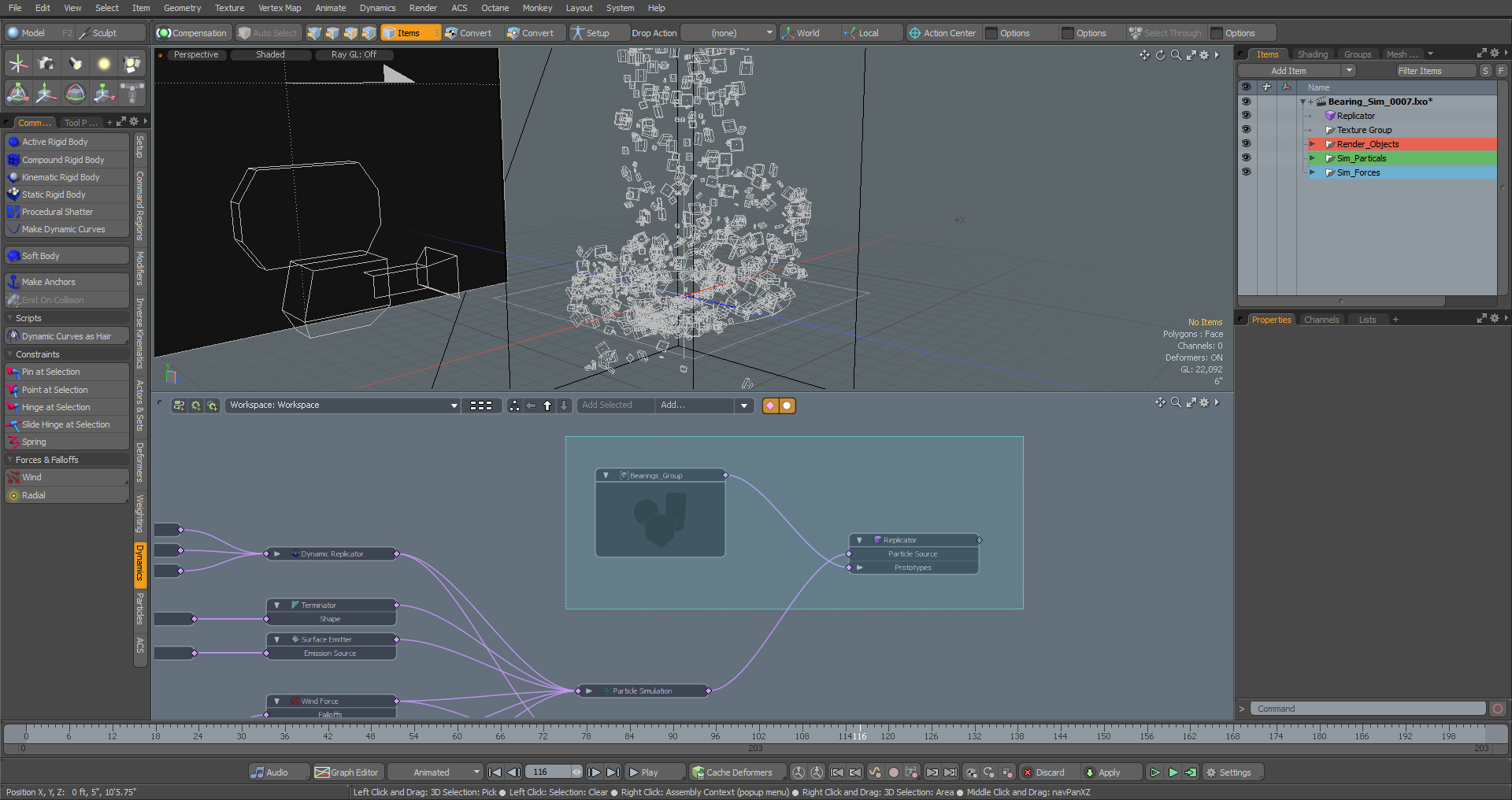

New with octane for modo, and I think I found a bug for replicators being transferred over to octane scatter.
Error message:
Tried to access pin via an invalid index 1
Tried to access null node pin
Can't connect node 'Replicator scatter' (NT_GEO_SCATTER, 000000131F406000) to static pin 'unknown' (P_UNKNOWN, type PT_UNKNOWN) of node '' (NT_UNKNOWN, 0000000018E55470)
Tried to access pin via an invalid index 2
Can't connect node 'Replicator scatter' (NT_GEO_SCATTER, 000000131F407EE0) to static pin 'unknown' (P_UNKNOWN, type PT_UNKNOWN) of node '' (NT_UNKNOWN, 0000000018E55470)
My scene is just a replicator with a group of meshes plugged into its prototype field, was able to fix it by replacing the group with one mesh.

That situation should work. Are you able to send me the scene which resulted in those errors pls?

Will pm you the file, however I discovered that I get the error when do a animation render.

This issue appears to have been introduced in that latest version of the plugin, and I will fix it for the next release. In the meantime, you could try installing the previous STABLE release, which may render correctly for you. Also be aware that rendering motion blur on replicator objects from without the plugin does not work - you need to export to Octane Standalone (via the octane.saveAnimation command) if you want motion blur on the bearings.

Thank you for looking into it, I will use the previous stable release for this project for now.
